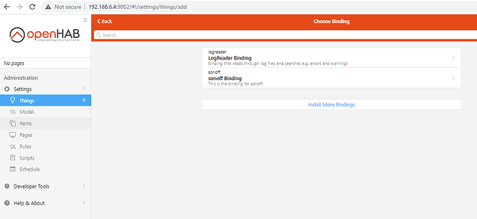

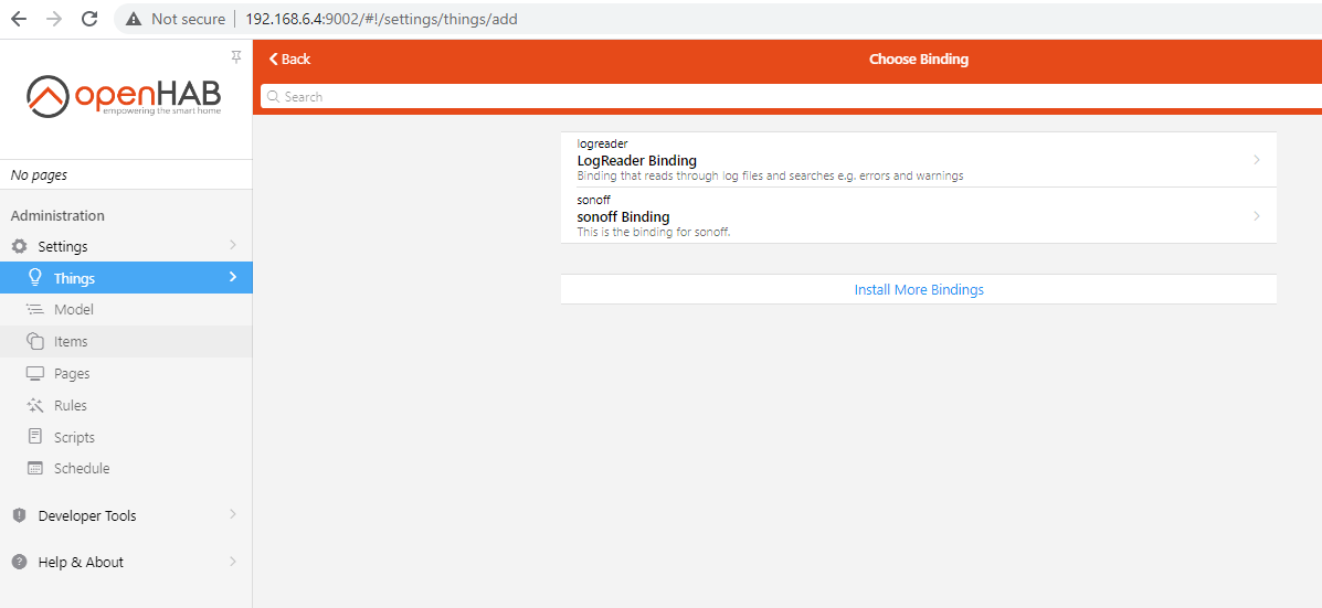

Shows up on mine so im not sure. maybe re-download, remove, wait 30 secs and readd, then refresh ui page.
things are then also shown:
