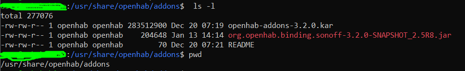

Hi.
Sorry to disturb with the same question, but i’m stumbled on instalation.
OH version: 3.2.0 (Openhabian instalation)
Sonoff binding placed to /usr/share/openhab/addons.
Tried 3 versons: org.openhab.binding.sonoff-3.2.0-SNAPSHOT_2.5R9.jar;
org.openhab.binding.sonoff-3.1.0-SNAPSHOT_2.5R6.jar;
org.openhab.binding.sonoff-3.2.0-SNAPSHOT_2.5R8.jar
restarting OH, changing owner and other tips - no result (in main ui, add thing - I see no sonoff binding)
Any idea where to look for the reason of the binding not working as supposed?

Hello Mokamobile,
can you share us pwd and ls -l on your addon folder ? And the user ID used by openhab ?
On my system, I’m just moving the jar in /usr/share/openhab/addons/ and after a few seconds, the new binding is β€œhere” on the GUI
have you check that the jar are fine ? (md5sum or sha ?)

Hello Mokamobile,
I’m using this one:
sha256sum org.openhab.binding.sonoff-3.2.0-SNAPSHOT_2.5R10.jar
c05ed1d1641a64d4fdf41e1ccc59cb337a7bd03e22627a5f4a067efe50706f05 org.openhab.binding.sonoff-3.2.0-SNAPSHOT_2.5R10.jar
maybe you should try it. and do a sha256sum to compare if the key is the same
if so, then maybe there is a way to see debug messages in /var/log/openhab/openhab.log file
When I’m tweaking mine (copied from the one I’ve sha256sum you), updates are done very quickly
BTW file size seems different than the one I use to have (3.1 or 3.2 are around 150k, yours is 204, but it might be a special version), latest version is currently:
thank you for your help.
  1. sha256sum - c05ed1d1641a64d4fdf41e1ccc59cb337a7bd03e22627a5f4a067efe50706f05 (same as yours)
  2. when placing the jar file to addons folder, nothing changes in openhab.log - just like system do not see that file is put there
  3. do any charges have to arrive when I’m putting the jar to addons folder?
    UPDATE:
    After removing …SNAPSHOT_2.5R8.jar and replacing it with …SNAPSHOT_2.5R10.jar from your link (actually, the same file I’ve tried first in my trial) - the binding arrived in OH UI (as described by topic starter).
Resume: I made same actions several times. Repeating this same action (no changes in algorithm) - gave suddenly positive result. OMG

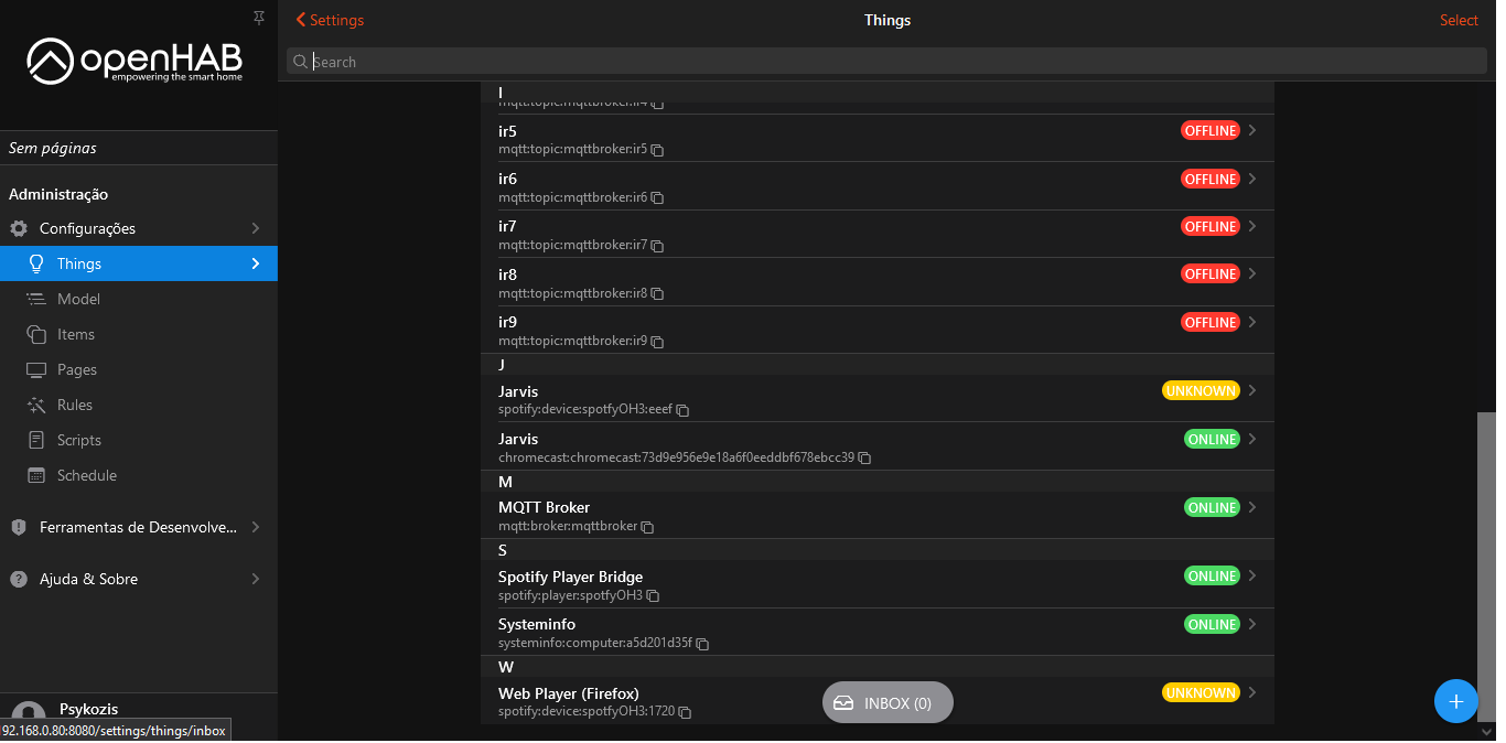

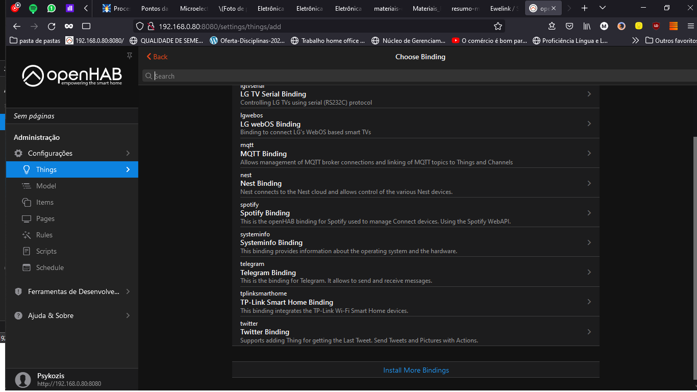

Hello everyone!
I’m another one, with the same problem… I couldn’t solve anything with the topics here.
I have openHAB running on Debian, on an OrangePi One, everything works great.
I tried to install this binding, with a β€˜wget openhab-sonoff-compiled/org.openhab.binding.sonoff-3.2.0-SNAPSHOT_2.5R10.jar at main Β· delid4ve/openhab-sonoff-compiled Β· GitHub’ in the folder " /usr/share/openhab/addons". As mentioned in the topics.
after that i created a file called β€œsonoff.things” in β€œ/etc/openhab/things/” with the credentials
Bridge sonoff:account:Myname β€œSonoff Account” @ β€œmyLocation”
[ email=β€œMy_ewelink_email”, password=β€œMy_ewelink_password”,accessmode=β€œmixed”]
As our friend RenΓ© helped me on the link, with a step by step, here
after that, accessing openhab via terminal β€œssh -p 8101 openhab@localhost”,
I already tried to bundle: start org.openhab…;
I already tried to give bundle:install org.openhab…;
I already tried to check the log:tail;
And nothing appears.

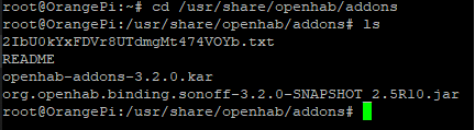

So you have a file org.openhab.binding.sonoff-3.2.0-SNAPSHOT_2.5R10.jar in /usr/share/openhab/addons right?
If so, you shouldn’t have to do anything, it will get automatically loaded. It might not work if it has dependencies though (they don’t get automatically loaded).
Can you post what you get if you log in to the karaf console and enter list? You should see the sonoff binding listed and it’s status. If it’s not Active it might mean that it’s waiting for some dependency to be loaded.
What is sitting in your inbox? can you add the sonoff bridge there?
thanx for your feedback Nicholas!
this way, right?
I can’t find it :confused: see below
neither here !

I recently re-installed openhab and had problems with the .jar file. I downloaded the org.openhab.binding.sonoff-3.2.0-SNAPSHOT_2.5R10.jar
with wget on the raspberry but then it would not work although the file was existing in /usr/share/openhab/addons.
Later I downloaded the file on windows from here: openhab-sonoff-compiled/org.openhab.binding.sonoff-3.2.0-SNAPSHOT_2.5R10.jar at main Β· delid4ve/openhab-sonoff-compiled Β· GitHub (using the download button).
Then I transferred the file to the raspberry with WinSCP and it worked immediately.
