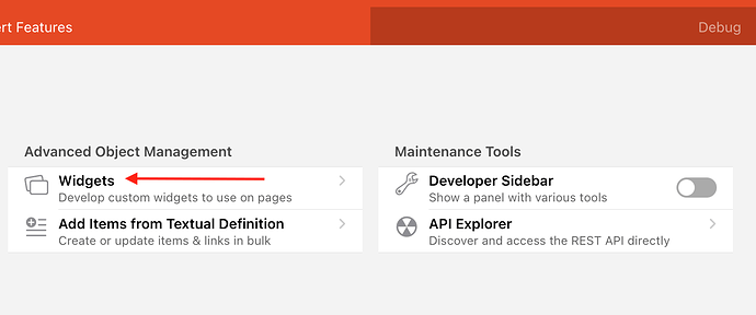

  1. Open Widgets under Developer Tools.
  2. Click the + button to create a new Widget.
  3. Copy the YAML from one of the examples above.
  4. Save.

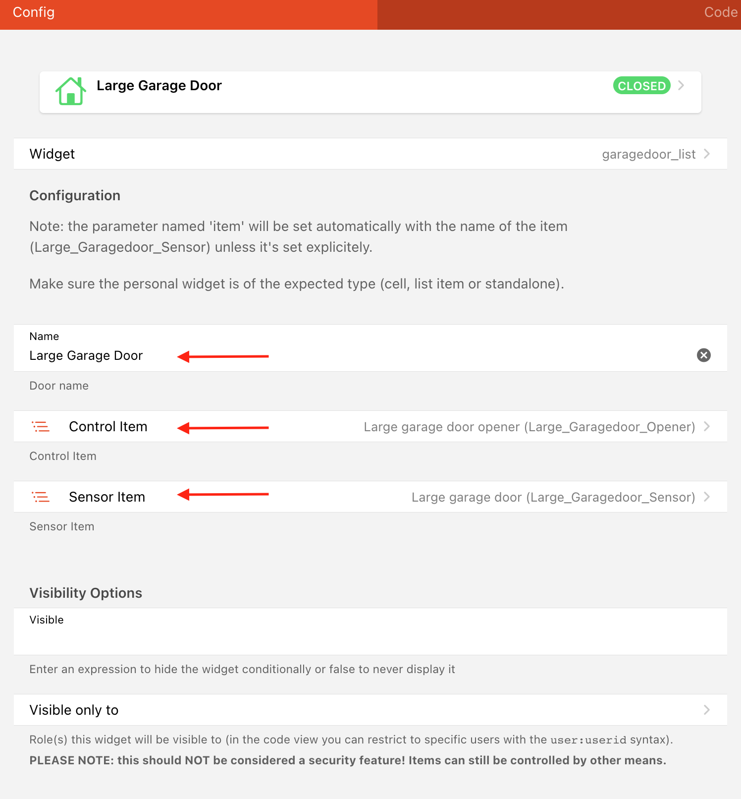

  5. Go to your Item (Point Item, not Location or Equipment) either in the Items settings or the Model.

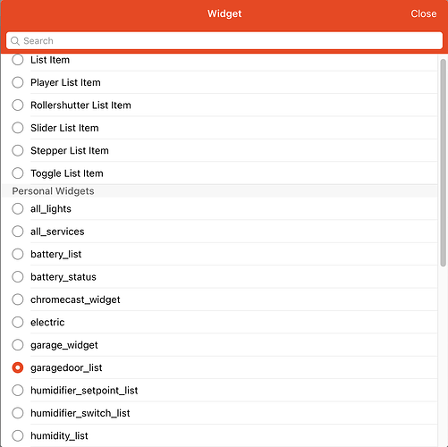

  6. Select “Add Metadata” and select “Default List Item Widget”
  7. Select the custom widget from the list under “Personal Widgets”
  1. Fill out the properties defined by the custom widget.
  1. Refresh the page and navigate to your Overview page and look at the widget in one of the cards.
Note: these widgets only appear when the Item is presented in a list (hence the name “list widget”). It’s not going to change the widget you see at the top of the Item’s configuration page. That’s a standalone widget.
