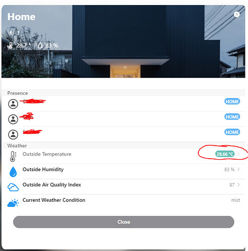

Question: When using badges and the State Description “[space]” variant, is there any way to still format the value shown? Example below which shows for temperature 28.66 C instead of just showing i.e. 28 C or 28.6 C:
When the State Description pattern is defined, items.MyItemName will have a .state and a .displayState. The .displayState is the state of the Item with the State Description pattern applied.
Thanks for your reply. Understood on the two different states.
The problem though is that if I use badge: =items[props.item].state it will display the actual state of the item, hence the 2 decimal places; when I use badge: =items[props.item].displayState it will just display an empty badge (as the pattern is a space). I was looking for a way to display the state though as before, with one decimal (or none) places (which before I had in the pattern).
Note that the oh-label-item component is only a oh-list-item displaying the item’s state in the after slot (to the right) - nothing more:
So if you don’t need this only additional feature (or don’t want it at all, because you’re using badges instead), there is no reason to use a oh-label-item over a generic oh-list-item.
