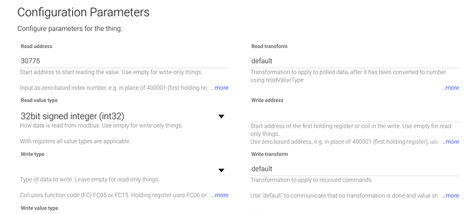

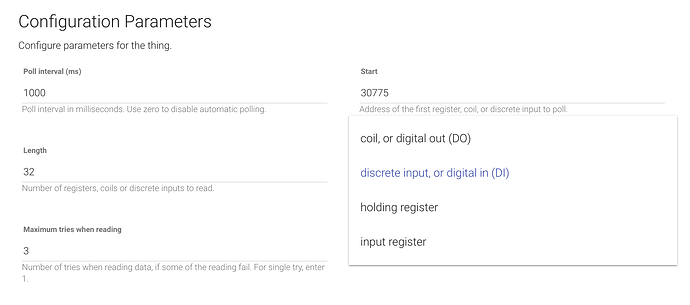

Hi Tom,
I tried to follow your example, but where do I fill in the read value type ?
In Paper UI, I only these see four options:
I also see no input fields for read transform and write transform.
Kind regards,
Pieter

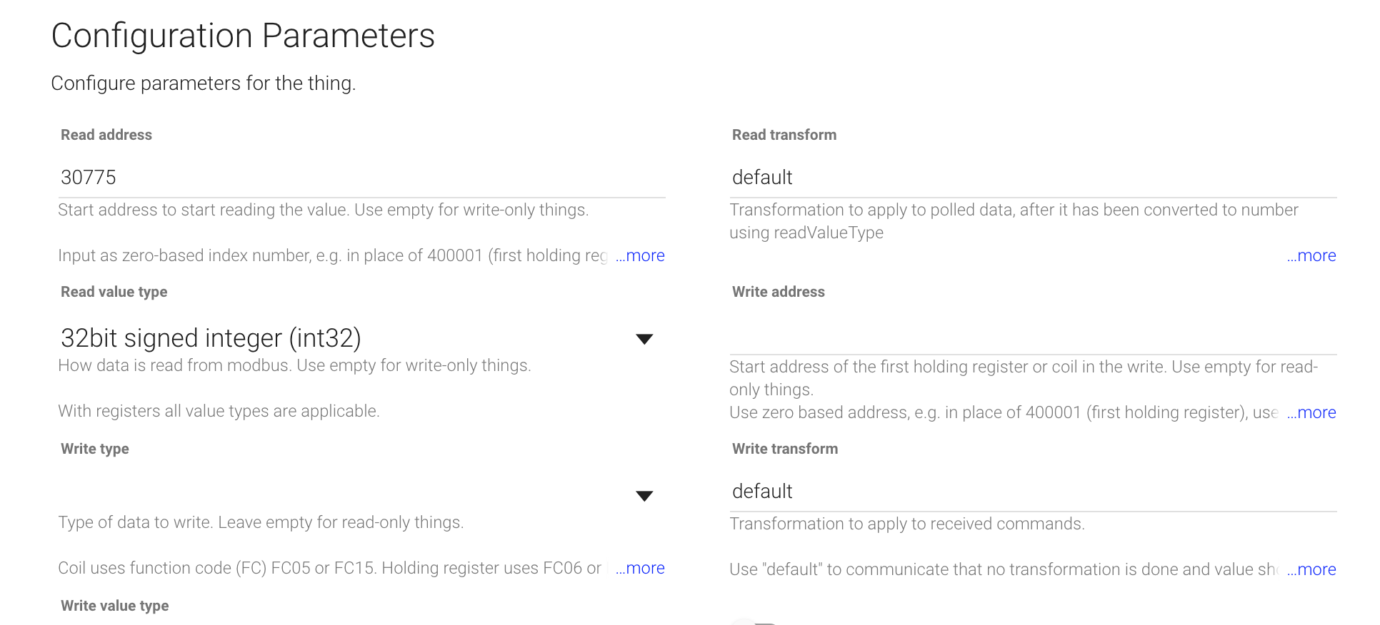

Hi Tom,
Forget my previous post. In the meantime I figured it out a bit more.
Only thing is that my Modbus data stays offline. Modbus TCP Slave and Regular Poll are online.
Pieter

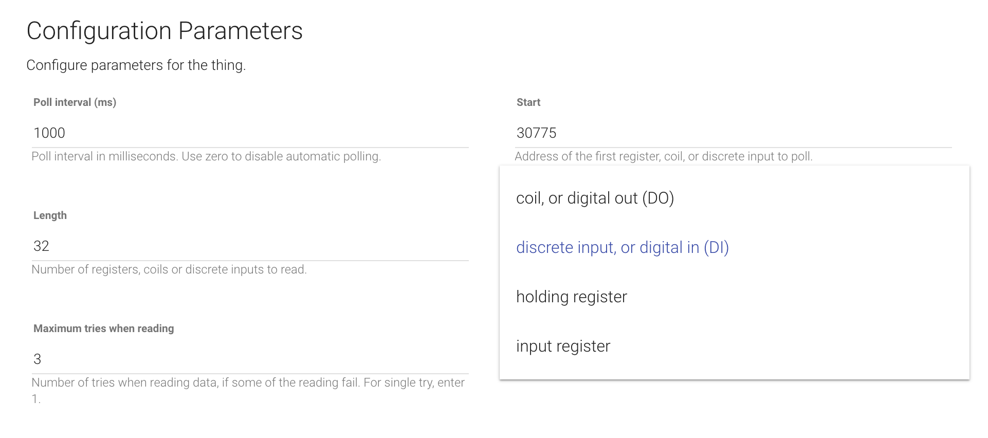

For now I created 3 things in my configuration.
Modbus TCP slave SMA, IP-address, Id=2 (bridge)
Regular Poll wich uses the Modbus slave bridge, start address 30775, type-input register, length=2
Modbus data where the bridge selection = Regular poll and Read Address = 30775
