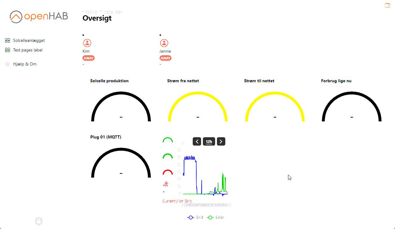

The last example is my mainUI page as it looks right now :smiley: (dont mind the missing data from the items.. Its an cloud issue I cant seem to fix. It works fine in local mode).

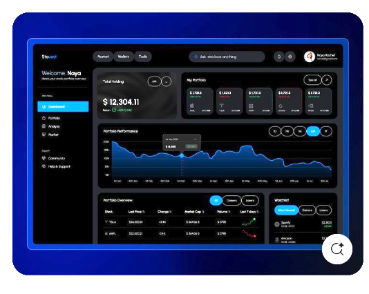

The first example is really dificult, as openHAB does not have user management, therefore user based information is not available. This takes a big part of the screen in the example.

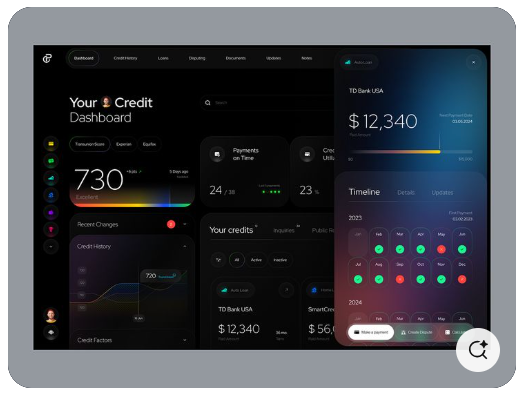

Dashboards 3 and 4 are stock/finance dashboards, which I do not see to be valid as templates for a smarthome dashboard. Even the information can be shown on an openHAB dashboard, I will not provide examples for those two.
My focus is on smarthome, not finance.

I know, but see the lower right of the first example. This is about editing users…
Humm - how about… adaptation? It doesn’t matter much the topic as long as they look - what is decidedly subjective - cool right?

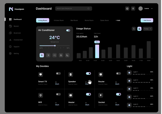

And the others, instead of finance why not… energy … overview. Not management. Just showing “these items are consuming this amount of energy” and maybe a line showing the consumption of the current day.
I see these dashboards not for what they are showing but for what we can take from them. Not the content itself but the art, organization, and such.

As for the finiance example, a user could exchange the data with Energy readings or anything simular, and there you have a smarthome purpose.
The user management could be exchanged with a present detection, and there you have another smarthome purpose.

Financial numbers and energy readings will use different item types which will need different formatting snd styling. You cannot simply exchange the information to be shown. Next issue will be item naming, which will be completely different.

My experiences with the widgets I use, I find them fairly simple to configure regarding which items to use. Hardest part is getting them to match the page/dashboard/design. And when I find a widget which needs some tweaking, Im totally lost as I have no idea what to look for in the code or I have to ask the developer for help.
So I end up using the standard “card” alike sizes and layout, as you can see from the last example in the first post, which make it look totally stupid :slight_smile:
This is my “work in progress” of my Solar/Energy pices/heatpump kinda like page/dashboard.. Its nowhere close to what I had in mind, but thats as far as I can go, and it looks like shi*** :smile:
Cause the widget I see are fairly simple configurationwise.
And you look for tweaking as many options for customizing are „hardcoded“ and not put into pops.
Let‘s see where this all leads to…
Your work in progress is the same one I modified and I use it everyday and it just works.
I have tried other solar widgets but I find this one the easiest to read.
