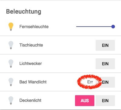

while working with my config files I got this strange behaviour - someone here perhaps could explain me what’s going wrong?
I’ve got a Homematic HM-LC-Dim1T-FM dim actor, and I defined two items via items config file; the both are labeled as “Bad Wandlicht”, and that’s what they should show up in sitemap.
Dimmer Badezimmer_1_Wandlicht
  "Bad Wandlicht"
  <light>
  (gSK_HS_2, gBad, gLampen)
  { channel="homematic:HM-LC-Dim1T-FM:ccu2:MEQxxxxxxx:1#LEVEL" }
Switch Badezimmer_1_Wandlicht_Toggle
  "Bad Wandlicht"
  <light>
  (gBad)
Relevant part of my sitemap file goes here:
    // Badezimmer Wandleuchten
    Slider item=Badezimmer_1_Wandlicht
      visibility=[Badezimmer_1_Wandlicht_Toggle=="ON"]
    Switch item=Badezimmer_1_Wandlicht_Toggle
      visibility=[Badezimmer_1_Wandlicht=="0"]
      mappings=[ON="Ein"]
What happens when using this sitemap is this:

And that’s the part I can’t understand: I never told to use this “%.2f %%” format - where does it take this information from? The only possibility to avoid this error message is to explicitly set the label to something like “Bad Wandlicht [%s]” - but I think it has to work without too, hasn’t it? I have lots of other items and no problems so far… I already deleted the items and re-created them with another item name, restarted openHAB etc, but when it comes up, it recognizes this item again and throws the error…

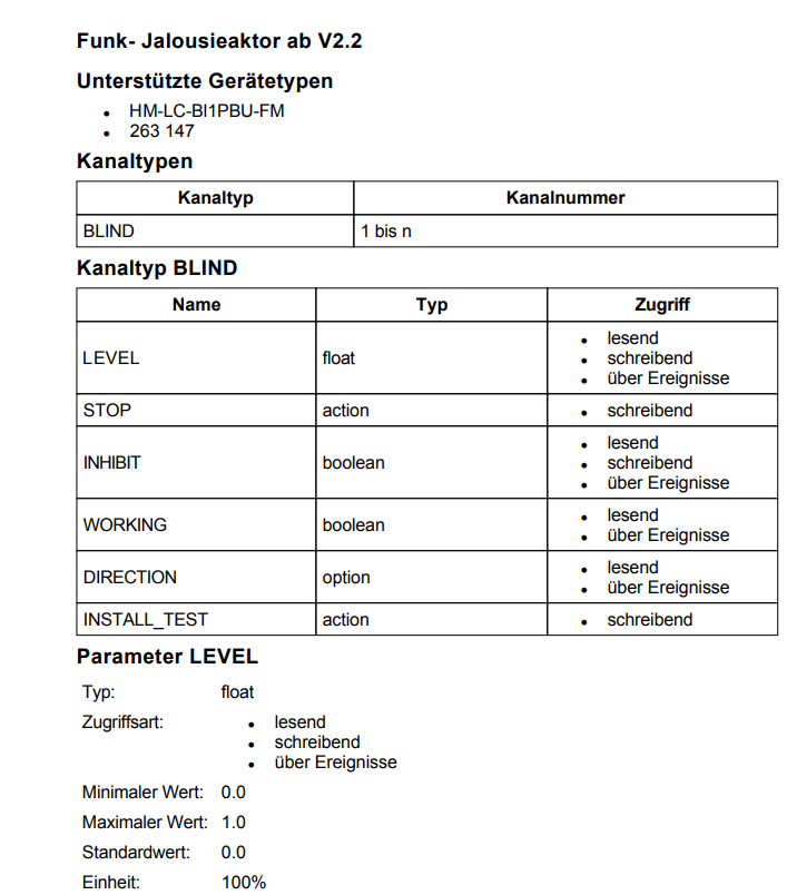

Hi Marianne,
i’m not sure, how the binding will handle ON and OFF.
The homematic documentation shows the following for the LEVEL channel.
LEVEL is from type FLOAT an has a range from 0.0 to 1.0. So the binding has to translate ON/OFF to 0.0 or 1.0. I’m not sure, if this done in the binding for this device. For dimmers, like HM-LC-Dim1TPBU-FM this will work. I can’t tell you why, maybe someone could explain it.
I think you have to do a workaround like the following:

As mentioned in the answer before, the implementation of some commands is not straightforward.
I have a lot of dimmers (HM-LC-Dim1TPBU-FM) installed, where the LEVEL channel understands ON and OFF sent as command. Also 0 switches off, and 100 switches on the light. That’s a bit weird. But I think, the dimmer item will handle this,
(https://docs.openhab.org/configuration/items.html) as the dimmer item will accept OnOff, IncreaseDecrease and Percent as possible values.
Otherwise you could try the offical commands from the rollershutter item, as mentioned here:
Possible commands are “UpDown, StopMove, Percent”. So try the following on your sitemap, maybee it works as expected.
