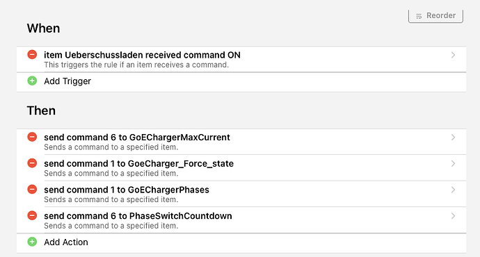

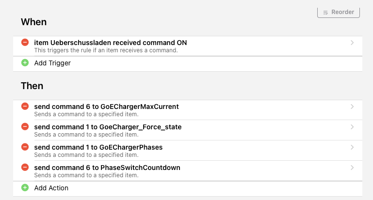

Rule to turn on Excess charging:
configuration: {}
triggers:
  - id: "1"
    configuration:
      command: ON
      itemName: Ueberschussladen
    type: core.ItemCommandTrigger
conditions: []
actions:
  - inputs: {}
    configuration:
      command: "6"
      itemName: GoEChargerMaxCurrent
    type: core.ItemCommandAction
  - inputs: {}
    configuration:
      itemName: GoeCharger_Force_state
      command: "1"
  - inputs: {}
    configuration:
      itemName: GoEChargerPhases
      command: "1"
  - inputs: {}
    configuration:
      itemName: PhaseSwitchCountdown
      command: "6"

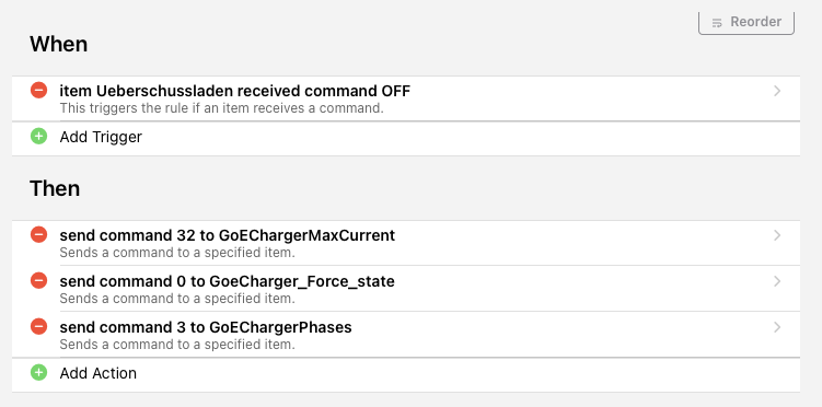

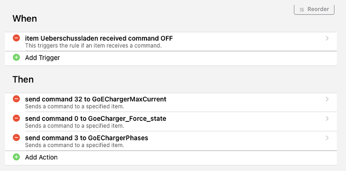

Rule to turn off excess charging:
configuration: {}
triggers:
  - id: "1"
    configuration:
      command: OFF
conditions: []
actions:
  - inputs: {}
    configuration:
      command: "32"
  - inputs: {}
    configuration:
      command: "0"
  - inputs: {}
    configuration:
      command: "3"
