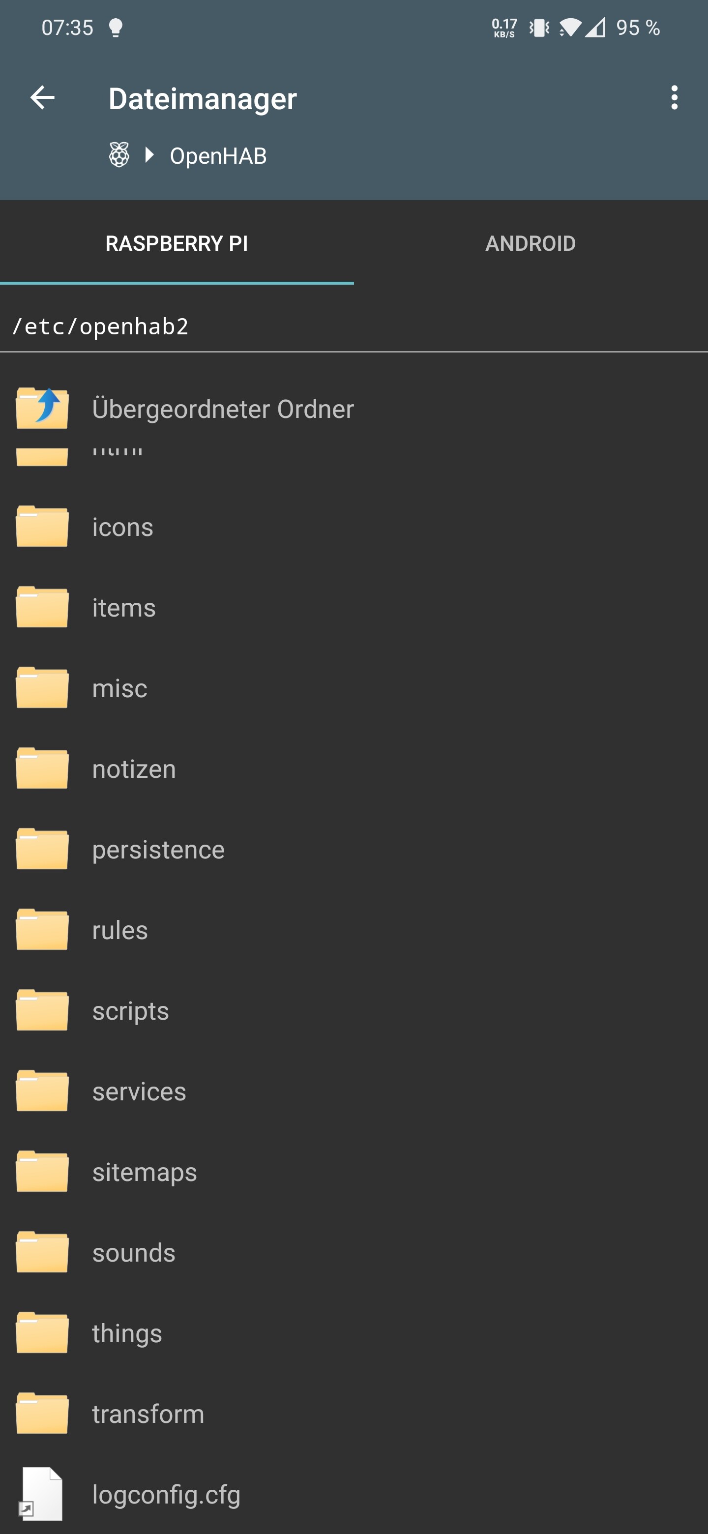

I added this to /srv/openhab2-userdata/etc/org.ops4j.pax.logging.cfg
Hint: for testing purposes and/or fast access to the file you can create a symlink to the file into your openhab config folder:
So you can change settings easily any time without opening an ssh session
