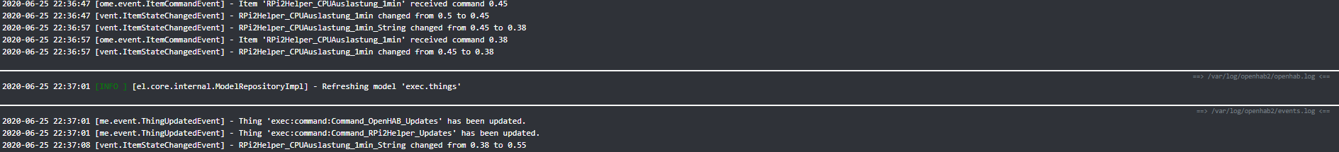

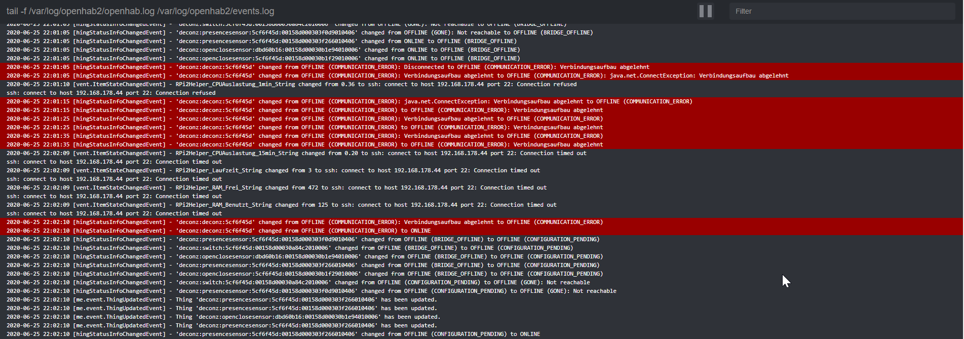

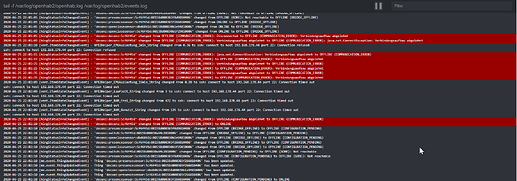

Today I found out on how to change the look of the OpenHAB Log viewer. I was quite tired of the old look and like the new appearance of my logs. Have a look:

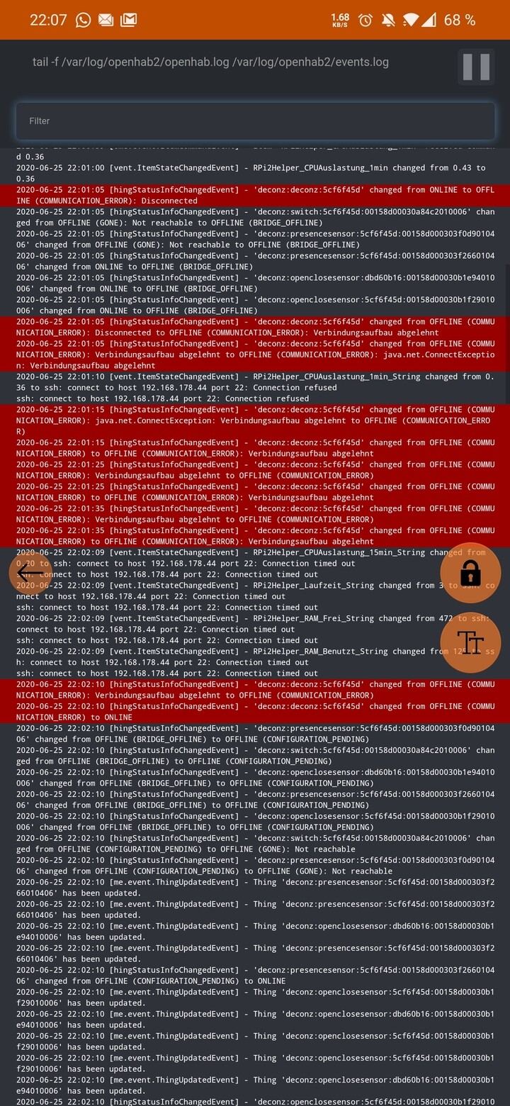

On mobile this looks like this

Furthermore I added the highlight-preset to have all text as white and change some backgrounds
“words”: {
“[ERROR]”: “color: red;”,
“[WARN ]”: “color: orange;”,
“[INFO ]”: “color: #0ED600;”,
“Node is DEAD”: “color: red;”
“lines”: {
“INFO”: “color: #FFFFFF;”,
“:”: “color: #FFFFFF;”,
“/var/log/openhab2/openhab.log”: “text-align: right; font-size: 0.8em; border-top: 2px solid #FFFFFF; color: #FFFFFF;”,
“/var/log/openhab2/events.log”: “text-align: right; font-size: 0.8em; border-top: 2px solid #FFFFFF; color: #FFFFFF;”,
“ERROR”: “color: #FFFFFF; background-color: #990000;”,
“model.script”: “background-color: #00918D; font-weight: bold; color: #FFFFFF;”
