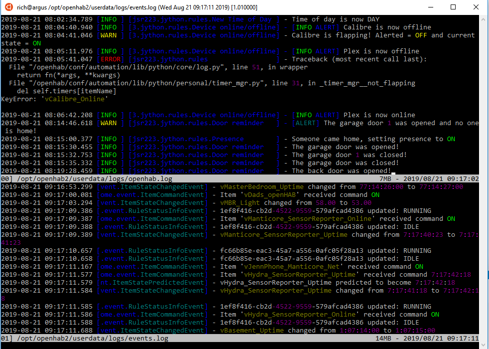

When tailing a log file, it can look like a sea of black and white and everything blurs together. Here’s something really easy to put some color in your logs to help identify what you are looking for.
tail -F -n5000 /opt/openhab2/userdata/logs/openhab.log | sed --unbuffered -e 's/\(.*\[ERROR.*\)/\o033[1;31m\1\o033[0;39m/' -e 's/\(.*\[WARN.*\)/\o033[1;33m\1\o033[0;39m/' -e 's/\(.*\[INFO.*\)/\o033[1;32m\1\o033[0;39m/' -e 's/\(.*\[DEBUG.*\)/\o033[1;34m\1\o033[0;39m/' -e 's/\(.*\[TRACE.*\)/\o033[1;35m\1\o033[0;39m/'

I use multitail with Christoph’s color coding scheme for openHAB to do much the same thing. I like multitail because it supports tailing more than one file and you can tail a file on another machine. the color coding isn’t as dramatic as coloring the whole line though which could be handy in a number of situations. I’ll be bookmarking this post for sure.
