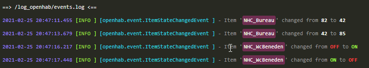

PROCESS
  1. I modified app.js adding some (very dirty!) code, in order to add RegEx support, and to use css classes instead of html hardcoded css and to implement the theming feature. I modified a few pieces of code in this file, but left the original code commented for reference. Here is the resulting file:
  1. I created a new json starting from openhab_dark.json (dark theme of openHAB) matching also the new options available in the modified js:
  1. I added a new css files, that includes the rules both for the dark theme and for the light theme:
In the same folder I added bootstrap.min.css:
  1. I modified the file index.html file to include bootstrap, the button for theming and the variables to store the last used theme:
  1. In order to make Frontail load the new css and json, the file /etc/systemd/system/frontail.service needs to be edited:
sudo nano /etc/systemd/system/frontail.service
The line to modify is:
ExecStart=/usr/lib/node_modules/frontail/bin/frontail --disable-usage-stats --ui-highlight --ui-highlight-preset /usr/lib/node_modules/frontail/preset/openhab_AEM.json --theme openhab_AEM --lines 2000 --number 200 /var/log/openhab/openhab.log /var/log/openhab/events.log
Please note that the json has the extension, while the css doesn’t.
Pay attention to edit it according to the correct paths of the json file and logs.
Also, this is the line modified for OH3. If you are still in OH2, the log paths in the final part of the line may be .../openhab2/... instead of .../openhab/...
  1. The only thing left is to reload the daemon and restart Frontail:
sudo systemctl daemon-reload
sudo service frontail restart

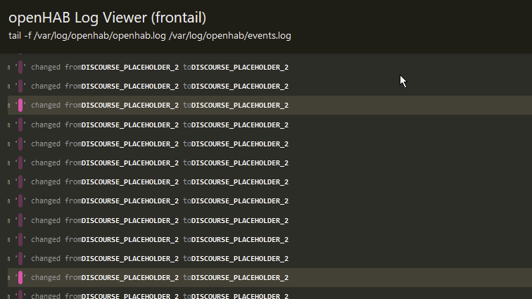

But now.. my log looks like this:
what am i missing?
LG Jay
Hello Jay,
I just noticed that there was a problem in the copy-paste of my app.js code, for some reason it added some funky “DISCOURSE_PLACEHOLDER_2” text where it should not be. I udated the post with the correct code, now you should see it correctly, try to see if it solves your problem!
You are correct about escaping the \ - actually its the same on my code. Again, for some reason this part was broken in my post. There was a problem a few days ago, and my first post got lost with the issue of the forum - probably when I reposted, the code from the backup was messed up and I didn’t notice. I am going to check all the code so that it is correct. Thank you for pointing out!

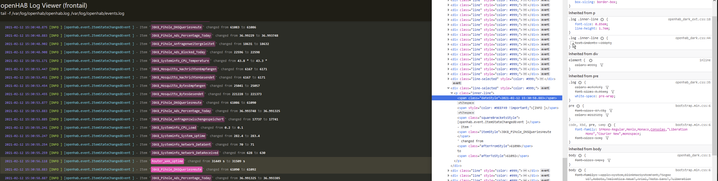

It seems like the RegEx rules are not working.
Item name is defined by:
"Item '(.*?)'": "itemStyle"
so it should add a span with class itemStyle around the item name.
Then itemStyle css rule defines the appearance.
If I were you I would try to inspect the HTML code to see if:
  1. the span is applied: if not, then the problem is in the RegEx
  2. the style is applied: if not, there’s something wrong with the css rule. Take in consideration that things like display: inline-block; may be problematic if not supported by your browser / webView.
The same basically applies for all the rest.
For the date, check if the format of the RegEx corresponds to your layout (yyyy-mm-dd hh:mm:ss.fff):
\\d{4}-\\d\\d-\\d\\d \\d\\d:\\d\\d:\\d\\d.\\d{3}
in my case corresponds to eg:
2021-01-26 14:35:25.323
Here’s an example of the output html in my Frontail:
<div class="line-selected" style="color: #999;">
	<p class="inner-line">
		<span class="dateStyle">2021-02-12 14:35:00.323</span> <span style="color: #9EEF49 !important;">[INFO ]</span> <span class="squareBracketsStyle">[openhab.event.ItemStateChangedEvent ]</span> - Item '<span class="itemStyle">iSonoff_1AFE1C_Voltage</span>' changed from<span class="afterFromStyle"> 222</span> to<span class="afterToStyle"> 221</span>
	</p>
</div>

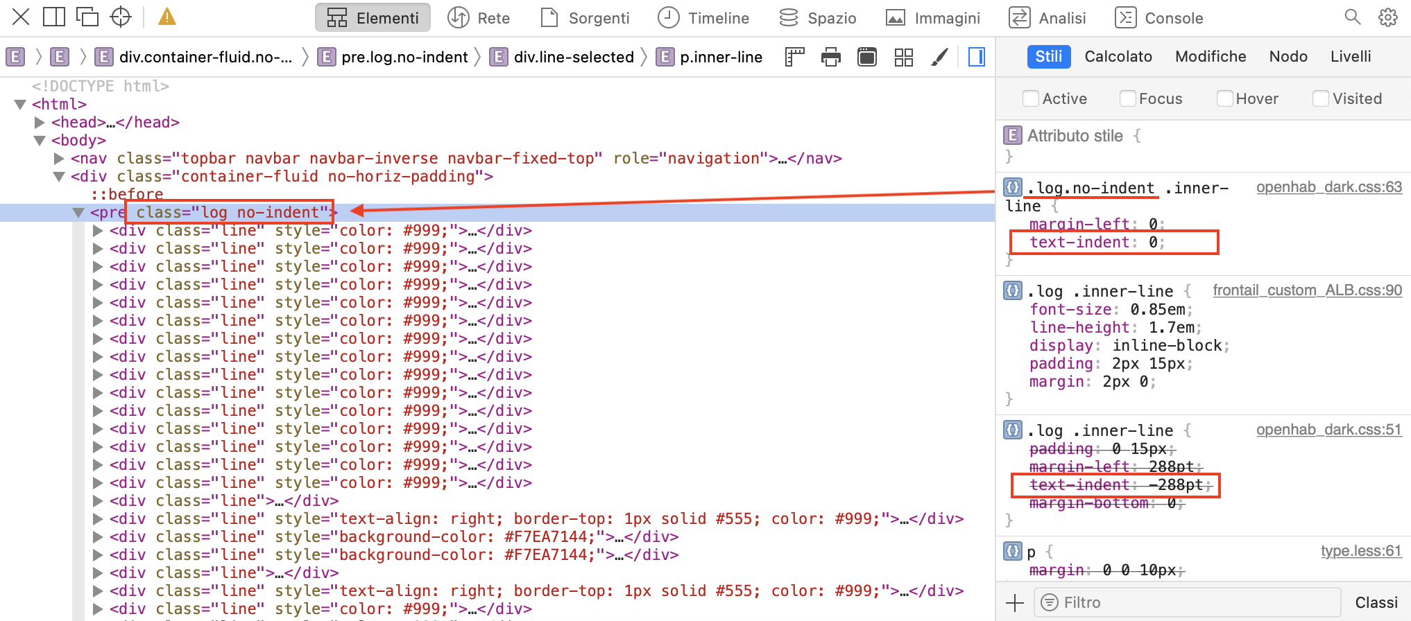

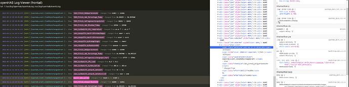

Thanks for the note for inspecting, i just didnt think about that, but that revealed, that:
my html seems fine, but i got one css problem:
this negative indent just collapses the fields and when i deactivate it i get a good looking log:
it comes from the openhab_dark.css:44 and i guess i just have to overwrite :slight_smile:
here the overview how it looks deactivated:
Thanks again for your help!
Thats a strange behaviour since that rule should be overwritten by the following rule for .log.no-indent .inner-line :
BTW not a big deal, you just need to add a rule in your css to overwrite it, and that should be ok!
Yeah, i already fixed it.
if i remember correctly the more specific/nearer instance should be taken, so it gets set to 0 and then to -288px..
but whatever.. now it works and it looks beautyful.
thank you again! =)
