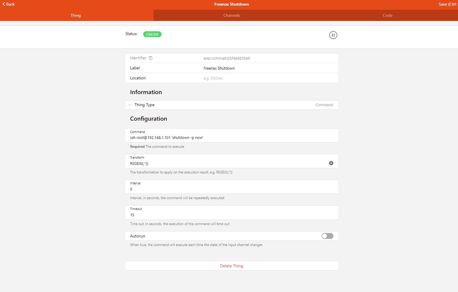

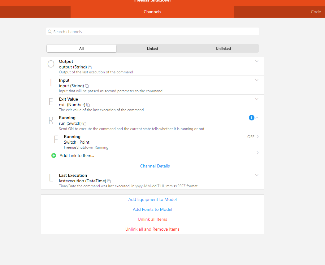

I have a problem with the exec binding, everything was fine for 2-3 years but all out of a sudden i get an error.
My openhab runs on a ubuntu server.
I configured an item and a thing to run this shell command : ssh root@192.168.1.101 ‘shutdown -p now’ to turn off my nas server. if i run the command from putty it runs everything is fine.
when i turn on the switch item andi i look in the openhab logs i see this warning and i don’t know what this means:
2024-03-14 14:57:45.634 [WARN ] [ng.exec.internal.handler.ExecHandler] - An exception occurred while executing '[sh, -c, ssh root@192.168.1.101 'shutdown -p now']' : 'Cannot run program "sh": error=0, Failed to exec spawn helper: pid: 1794900, signal: 11'
