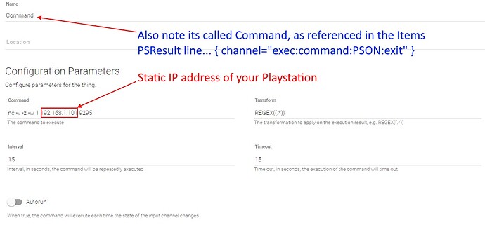

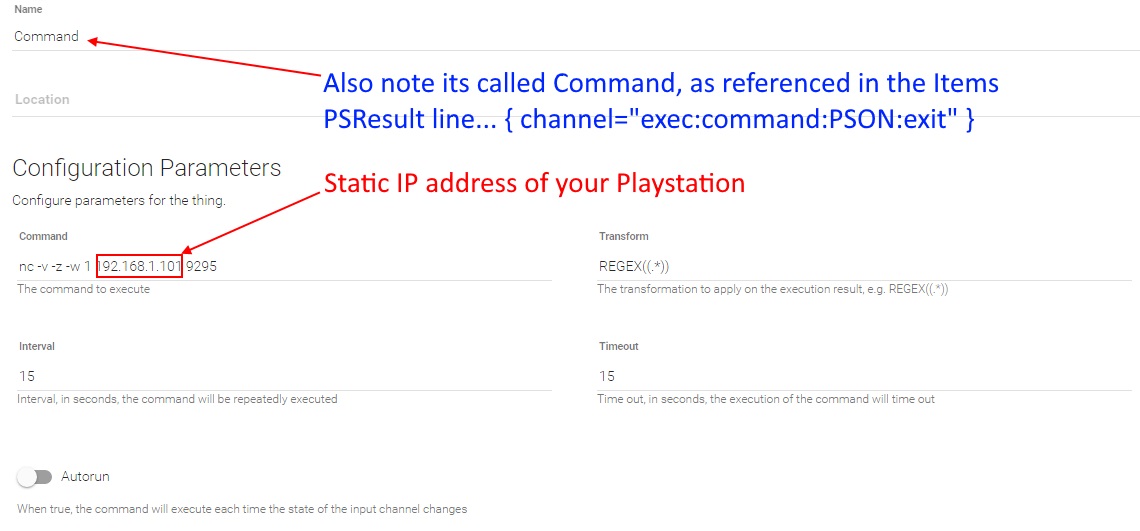

Heres my full setup…
Make sure youve installed Netcat (the NC command line… youll need it later).
Items
Switch 	PLAYSTATION 	"Playstation 4"		<playstation4>
Number 	PSResult 	{ channel="exec:command:PSON:exit" }
Sitemap
Switch	item=PLAYSTATION	mappings=["ON"="On","OFF"="Off"]
Rules
// Update switch status to On/Off if device manually switched on
rule "Update Playstation state"
    Item PSResult changed
	if (PSResult.state == 0) PLAYSTATION.postUpdate("ON") else PLAYSTATION.postUpdate("OFF")
// PLAYSTATION - On/Off
rule "PlaystationOn"
		Item PLAYSTATION received command ON
		executeCommandLine=("ps4-waker")
		Thread::sleep(2000)
rule "PlaystationOff"
		Item PLAYSTATION received command OFF
		executeCommandLine=("ps4-waker standby")
		Thread::sleep(2000)
In the Openhab PaperUI interface, go to Configuration > Things, click on the + symbol and add an Exec binding. In there, you simply need to add the netcat command with your IP address and the port 9295. So in the below command line, you would replace the 192.168.1.101 with the STATIC (it must be a static IP or you must have a fixed hostname set), with your Playstations IP address.
EDIT - My command, whilst it says “Command” as the name, is referenced by the name “PSON”.. I cannot recall if you need to change the name from “Command” to “PSON” when creating the binding… and its just the case that in my screengrab, for some reason its showing “Command” as the name, rather than “PSON”.
nc -v -z -w 1 192.168.1.101 9295
I also set mine to run the check every 15 seconds…
Other than that… Im assuming youve run the PS4Waker from the command line already and got it working (this HAS to be done to make PS4Waker work… assuming you are using PS4Waker).
That, I believe is all you need!!
