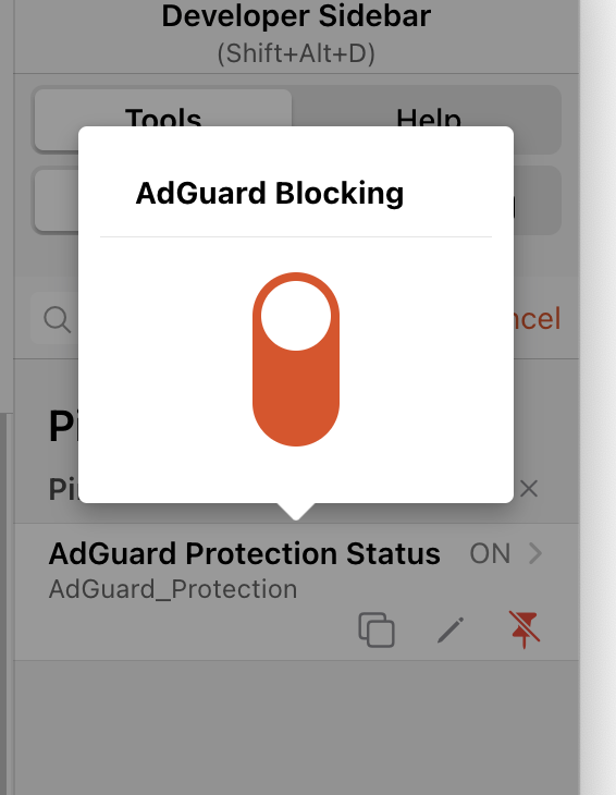

That’s a good approach. in fact that’s one of the reasons the Scratchpad Script exists. You can create that through the developer side bar.

- the default widget is usually a toggle. Even if the state is NULL, toggling the switch from MainUI anywhere the Item appears, will work
Yes, I knew I saw it somewhere but for the life of me I couldn’t go back to that same screen.

In MainUI you can find the Item under Settings → Items → Name of Item. The default stand alone widget will be shown at the top.
If the Switch is a part of the semantic model, you’ll find it in the appropriate card under the locations, equipment, or properties tabs.
And of course you can find the Item on the Developer Sidebar.
