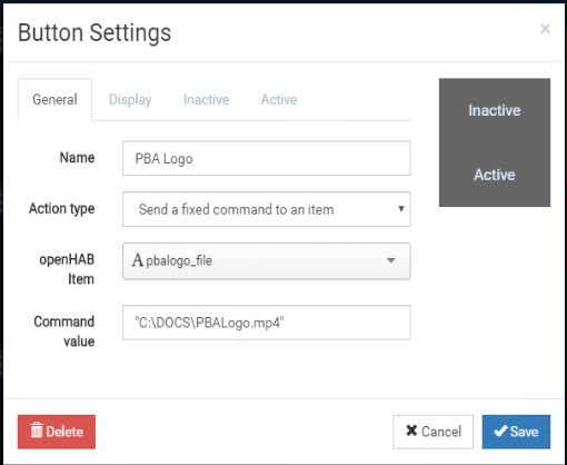

I’m running openhab on a windows 10 PC and I want to run a batch command file from habpanel. I’ve set the Thing and Items configs this way

Habpanel:
Im sending the file name for the video to run.
When I look at the log nothing is shown to be happening.

This is what is in the event log:
2019-07-16 15:13:57.342 [ome.event.ItemCommandEvent] - Item ‘pbalogo_file’ received command “C:\DOCS\PBALogo.mp4”
2019-07-16 15:13:57.344 [nt.ItemStatePredictedEvent] - pbalogo_file predicted to become NULL
The command to the send file name to the pba_logo item is working but how does it start the send command item pbalogo

So what I want is to pass the file from the habpanel button and have that exec the item pbalogo with the parameter received by pbalogo_file item
That’s fine, Item ‘pbalogo_file’ is a String type and you can send it any string you like as a command.
