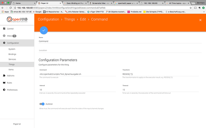

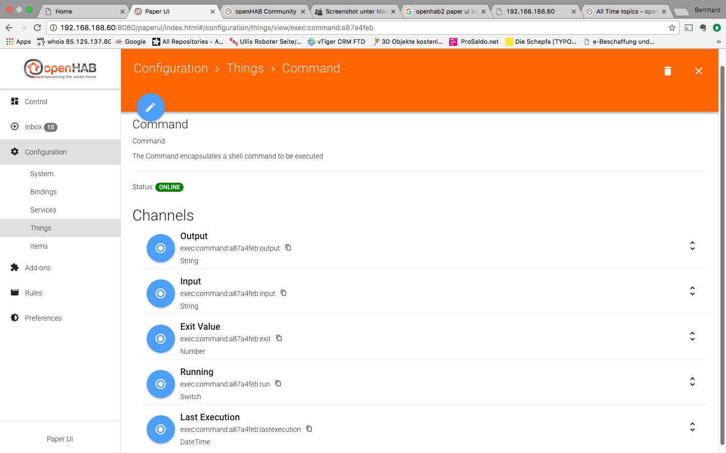

I’ve created the Exec-Thing in manually in Paper-UI and in the Simple Mode Paper UI created all items…
Anybody any idea why the script will not run?
