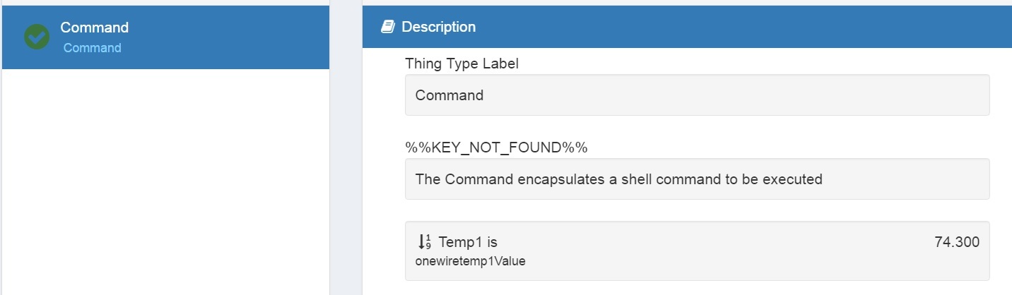

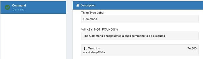

OK, I learned 2 new things today:
  1. Do not use “@@” in place of spaces in the command, it is not needed and
  2. For my particular application I should have used the output of the command (and not the exit value).

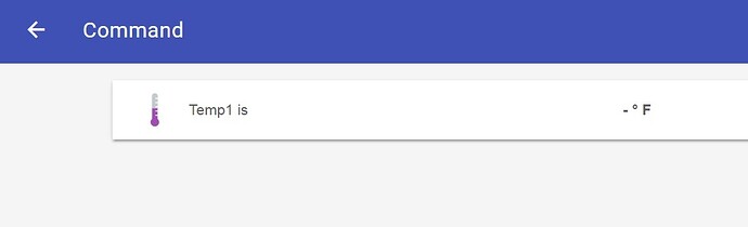

Now I get the correct reading in OpenHab, as verified in HAbmin, but I still cannot get the value to display properly in a sitemap:
This is Basic UI with sitemap: _default, so there is no file I can edit (that I am aware of). My custom sitemaps also do not report the Temperature reading.
I experimented with creating a Rule, as suggested, however I can now get valid readings and the script errors have been resolved, so I am back to using items and things.
Any guidance on getting the data to display in sitemaps?
Great you got that far. The result in BasicUI is normally shown when there is no or no valid value available. Please build your own sitemap and as always check the openhab logs for errors and value updates… sorry I can’t be of more help than that.
