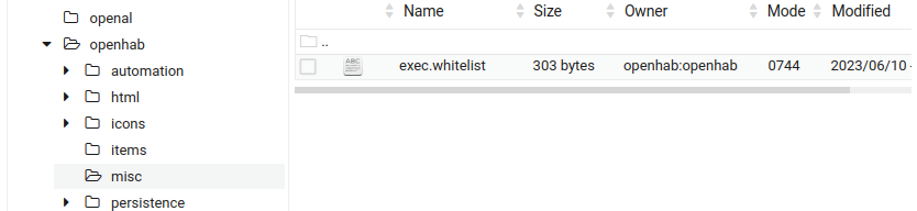

I think the access rights are correct - judging following screenshot:
Here is it’s content:

What about the directories with level above exec.whitelist ? Do they allow openhab to look into the directory ?
What is the output of
ls -ld /etc/openhab/misc/exec.whitelist /etc /etc/openhab /etc/openhab/misc
thank you for your fast response.
here is the output of
drwxr-xr-x 123 root root 12288 Jun 6 06:09 /etc
drwxr-xr-x 15 openhab openhab 4096 Jun 4 19:51 /etc/openhab
drwxrwxrwx 2 openhab openhab 4096 Jun 10 12:03 /etc/openhab/misc
-rwxr--r-- 1 openhab openhab 303 Jun 10 12:03 /etc/openhab/misc/exec.whitelist
