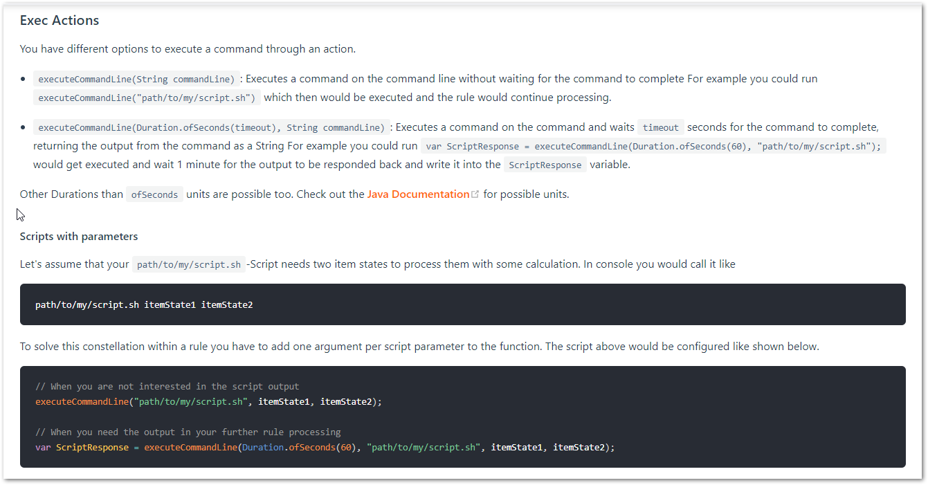

The @@ stuff is no longer used for OH3 executeCommandLine. Some more info:
I tried this:
executeCommandLine(Duration.ofSeconds(60), “sudo@@/app/scripts/openhab/myscript.sh”)
This doesn’t worked…
This.
See Actions | openHAB
