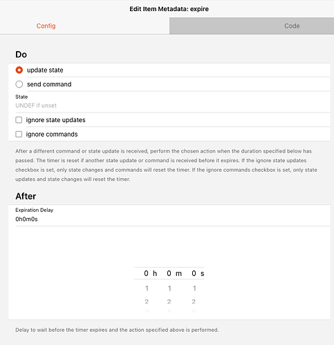

Hi, how can I use this ?
https://github.com/openhab/openhab-core/pull/2739
Set the property on the Expire metadata to ignore state updates.
value: 1h0m0s,command=ON
  ignoreStateUpdates: "true"
  ignoreCommands: "true"

Is it possible to include ignoreStateUpdates in this rule ?
Use the “store true to config ignoreStateUpdates into namespace expire for item ItemName” block.
