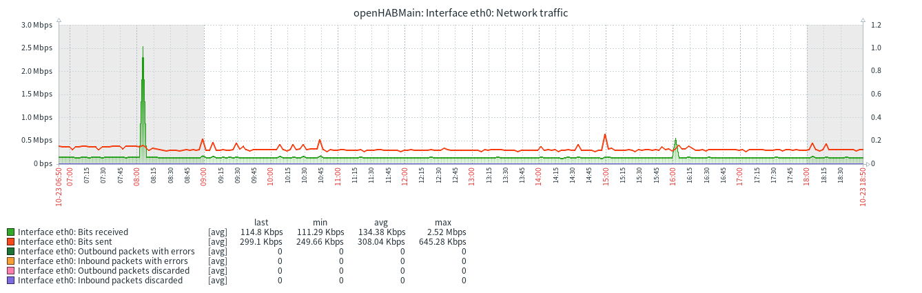

On my Raspi4, there’s only “pure” openHAB. Meaning, there’s not much other stuff like InfluxDB or other services running. I don’t even have other cronjobs or scripts running outside of OH4.
just to move a bit further away from my own topic! :wink:

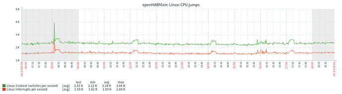

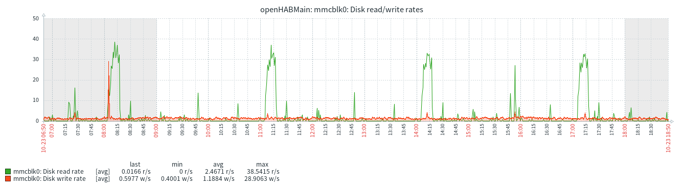

it just “feels” slow, and sometimes I have to wait for like 30secs or more to have the items listed in the UI or the rule loaded. Even for the cronjob-based rules, I notice some delays after writing the logs regarding the rules to disc (no, not the 20sec delay after each first start - even later on: rule supposed to start every 2mins at 15secs, but logs are only written at 16 or even 17 secs)…

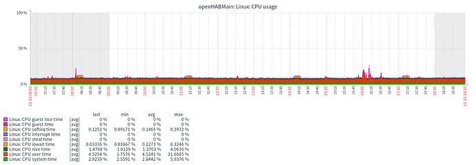

If I compare this to a vanilla installation, then there’s room for more. But yeah, perhaps it’s just a slow SDCard or some other low-level cause…? on the other hand, there’s spikes like this:

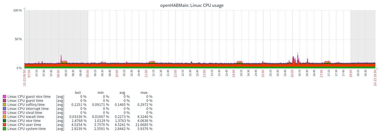

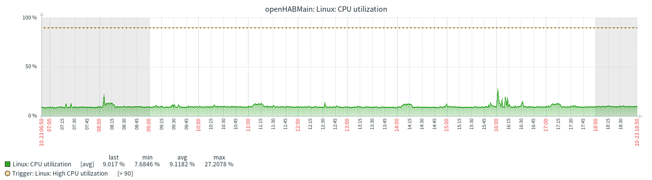

nothing special and the CPU usage stays normally below 0.2 or even 0.1

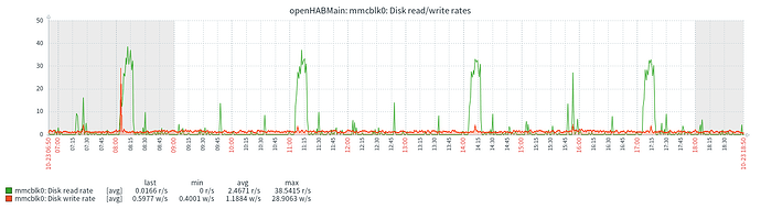

especially the 3hour mark, I don’t recall setting somethin for every 3hours…

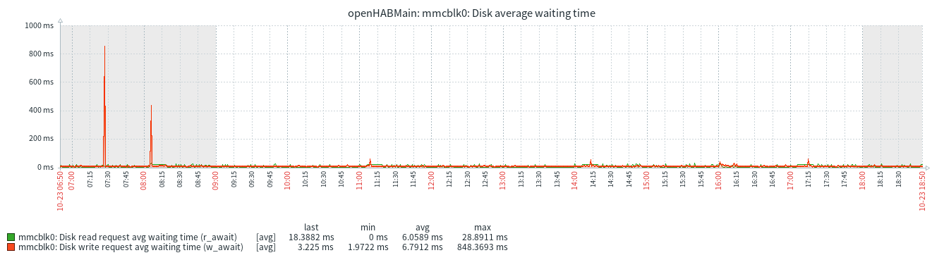

the disk wating time is also not suspicious:
…but still, there is something holding back. If it’s the “constant” changing of items? I have around 80 or more items, which change constantly, sometimes every second at least every 5 or 10 secs… Of course it won’t change I guess, it the items are filled via MQTT or via the “native” binding. But still…
back to topic: it would be much easier, to export and import items, or at least have some kind of multi-editing feature in the UI… :wink:

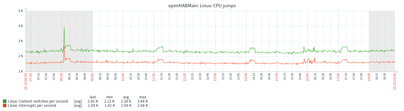

CPU is almost never the limiting factor. It should be the last thing to look into.
The primary limitations tend to be RAM, Network, and file IO. And it’s not the overall speed that is the major concern, it’s whether processes have to sit around and wait for a shared resource that they need. In those cases, your CPU use will be low because nothing’s happening. Programs are stuck waiting.
This would qualify to as a relatively modest OH instance. Just based on the Items alone, this should run decently even on an RPi 2. And these rates are pretty reasonable as well. Items is not your limiting factor.

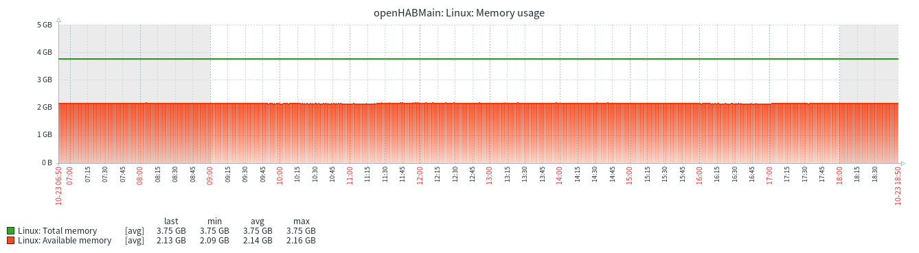

Whats the RAM and system load (system load is how many programs are stuck waiting around and you’ll see it listed in htop)?

RAM is stable:

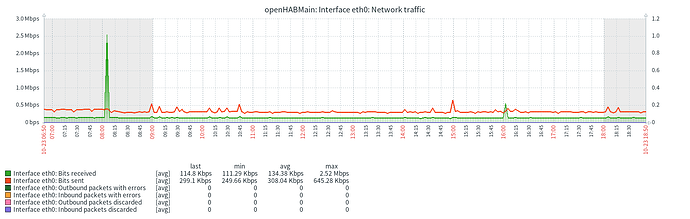

Network is well in all parameters:
