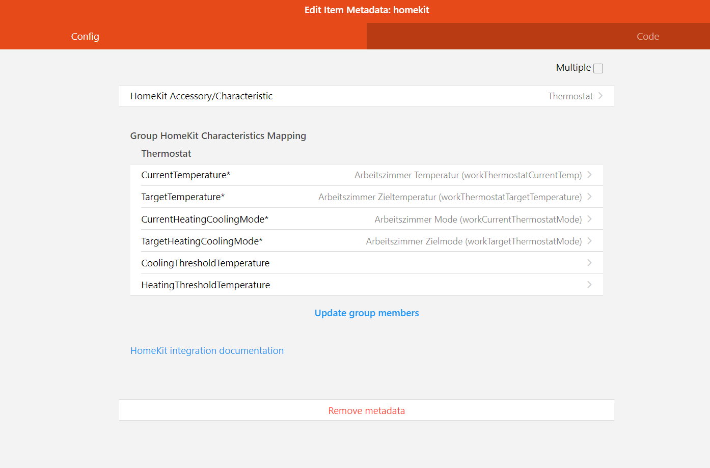

you dont need to put anything in the “code” tab. just link items at group item and click “Update group members”

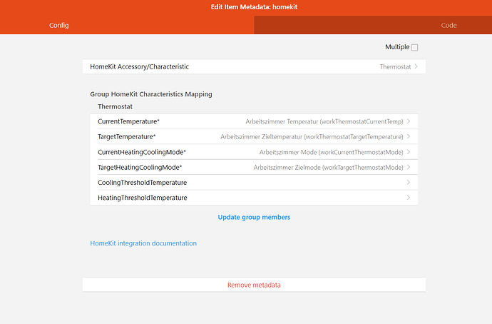

it looks like this on my side
unfortunatly the gui isnt working for me, after setting the mapping of the group members and clicking on “update group members” and also clicking on save, the change isnt saved.
Where can I do the textual config? In the item? Do I have to do it in the shell?
I click on Update and save:
Afterwards the settings are gone. Unfortunatly Im only allowed to post one picture.

Apple thermostat has mandatory items and without them it cannot create thermostat. so, you need to add homekit to all of them and to the group, so that apple knows they all belongs to the same thermostat.
the list of mandatory items you can find in the second column of this table
for thermostat they are:
  • CurrentTemperature
  • TargetTemperature
  • CurrentHeatingCoolingMode
  • TargetHeatingCoolingMode
so, please add all of them and the group, ignore the error in the logs until then
Hello eugen, on my first screenshot you can see that I added all mandatory items.
When I add the metadata to a single item, e.g. Current temperature to Thermostat.CurrentTemperature I see this in the logs:
22:14:43.985 [WARN ] [l.accessories.HomekitAccessoryFactory] - Accessory of type Thermostat must have following characteristics [CurrentHeatingCoolingMode, TargetHeatingCoolingMode, CurrentTemperature, TargetTemperature]. Found only [Item:tHeizgruppeSchlafzimmerEltern_ActualTemperature (Type=NumberItem, State=17.9 °C, Label=                                                    Actual Temperature, Category=Temperature, Tags=[Point], Groups=[tHeizgruppeSchlafzimmerEltern])  HomeKit type: 'Thermostat' characteristic: 'CurrentTemperature']
22:14:43.987 [WARN ] [omekit.internal.HomekitChangeListener] - Cannot create accessory Item:tHeizgruppeSchlafzimmerEltern_ActualTemperature (Type=NumberItem, State=17.9 °C, Label=Actual Temperature, Category=Temperature, Tags=[Point], Groups=[tHeizgruppeSchlafzimmerEltern])  HomeKit type: 'Thermostat' characteristic: 'Empty'
![image|690x139](upload://vfgMuBQMNPfQ2Qd7zBGTgDQQvol.png)
ignore error. just keep doing it. so, go to next item and add homekit data, one by one and then the group
the error also tells - “Thermostat must have following characteristics [CurrentHeatingCoolingMode, TargetHeatingCoolingMode, CurrentTemperature, TargetTemperature]”
add all of them and then openhab homekit will be able to create it
Thank you, your hint led me to the solution.
I just want to point out, that it is important to add the items first and THEN adding the meta attribute to the group.
