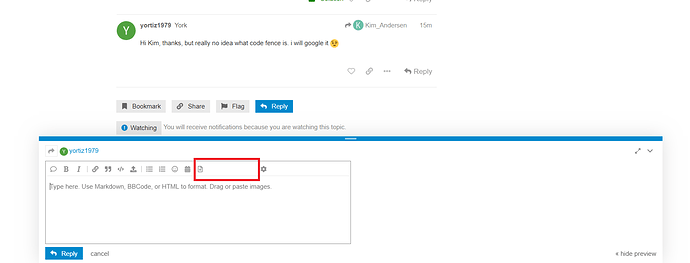

Hi Kim, thanks, but really no idea what code fence is. i will google it :wink:
Using the reply box in the forum, its easy.. Look at this screendump.. Notice the red square I have inserted, (unfortunatly there is no icons, but place your mouse on it and you´ll see).
@yortiz1979
thank you guys, i have learned a lot on this forum lately :slight_smile:
