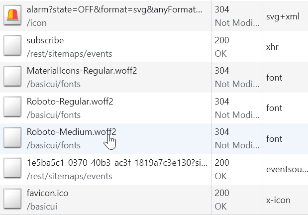

I’d like to access my home openHAB instance via the internet from my smartphone.
[Securing Communication and Access | openHAB] shows how to set up a reverse proxy.
This exposes the the whole openHAB instance to the internet. I’d like to have ony basicui accessible from the internet.
This would need a common path prefix that would be proxied. But if I look at the traffic of basicui, there is no common prefix.
One would need something like
/basicui/fonts
/basicui/rest
Has anybody worked on something like this?
Or is VPN the better option?
Thanks,
Juergen

Keep in mind that BasicUI has to be able to access the generic openHAB REST API and since BasicUI runs in the browser it means the REST API needs to be exposed as well. There isn’t a /basicui/rest because BasicUI doesn’t have it’s own REST API endpoint.
In this case it’s pretty much all or nothing.
