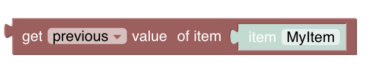

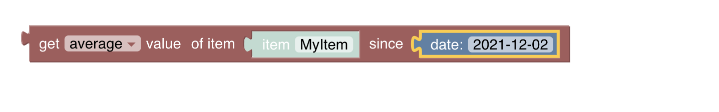

You little maniac! :wink: That has really cost me quite some headache because documentation is pretty rare about how to do that. I had to do a lot of trial and error but finally I even found a pretty simple solution. Now it looks like this
When choosing everything but “previous” the block looks like this:
and when choosing “previous” the block has changed to
so we only need one block. Hope you like that.
