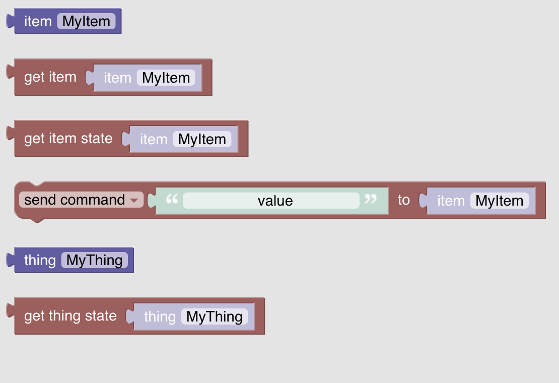

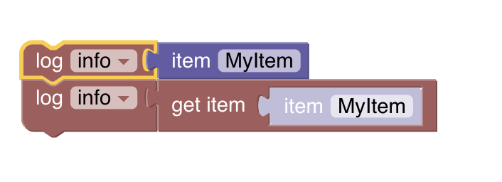

  • Things: What the difference between the purple MyItem and the red get item item MyItem? Is this the Items category?

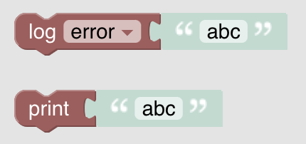

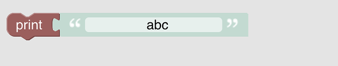

I have a question
I stumbled over the following print-block:
which generates
print(‘abc’)
  • The help tooltip says “Print a message on the console”. Which console is meant here?
  • What is it meant to be used for?
  • As the rules are run on the server side, wouldn’t the log-block enough or do I miss something?

Thanks for all the comments on the several groups. I won’t get into most of these as I have postponed working on these (like Persistence, Network Tools and Variables…) but regarding these here
The only usage I could imagine is to use the this in a log statement at the moment.

In JS rules code, most of the time you are not actually working with the actual Item but just the name of the Item. That appears to be what item(MyItem) does. I makes sense that it’s a separate block from just a plain old String block as you can get a drop down list of all your Items to populate it rather than requiring the user to remember and type Item names in.
The get item block though is useful and required in cases where one needs more than just the Item name. For example, the Item’s label, a Group’s members, tags, etc. I would expect to see some block chains along the lines of
for each -> get members of group -> get item -> item MyGroup
log(info) > get item label -> get item -> item MyGroup
Though it might make sense to collapse those and the get item remains understood rather than requiring the users to define it.

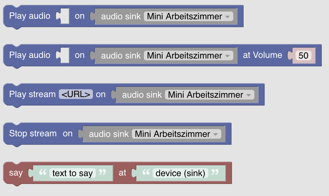

Here is the first drop of the new functionality. Note that I have taken out quite a lot to concentrate on a first delivery that can be easily tested and documented.
While you are testing it and start the documentation I would then continue working on it.
@ysc @kai If I provided the PR would you have time to review it? Does it make sense to provide several PRs so that it doesn’t become to big to be reviewed (like the original one)?
@Andrew_Rowe Would you mind downloading it and start documenting? I could provide tips for example how setup sound and voice via private message.

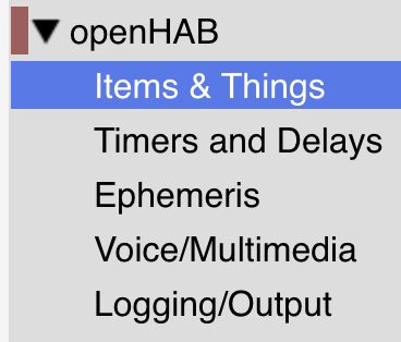

Here is what is part of the drop
New Openhab Menu
Items and Things
Timers and Delays
I have taken out timers for the time being as code generation is broken but it will be next thing to provide soon (which is why the label contains “timers” as well.

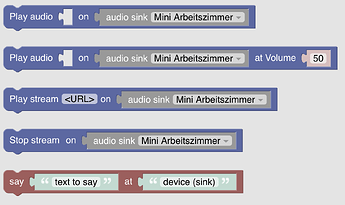

Voice / Multimedia
Logging / Output

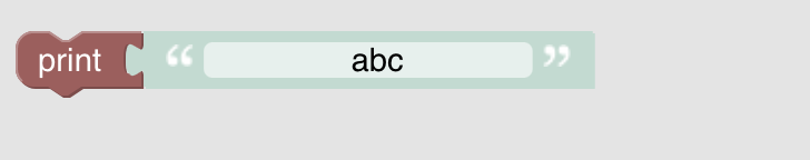

as I mentioned above, it is not clear to me what the print() command actually does, so I couldn’t test it.

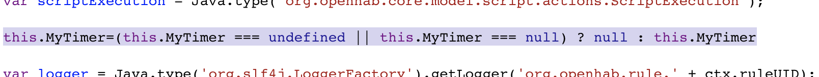

Looking at the blocks and the code generated I have a few comments.

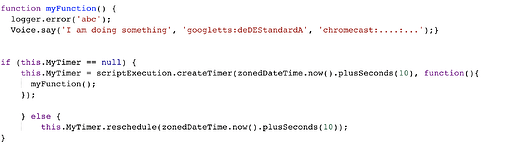

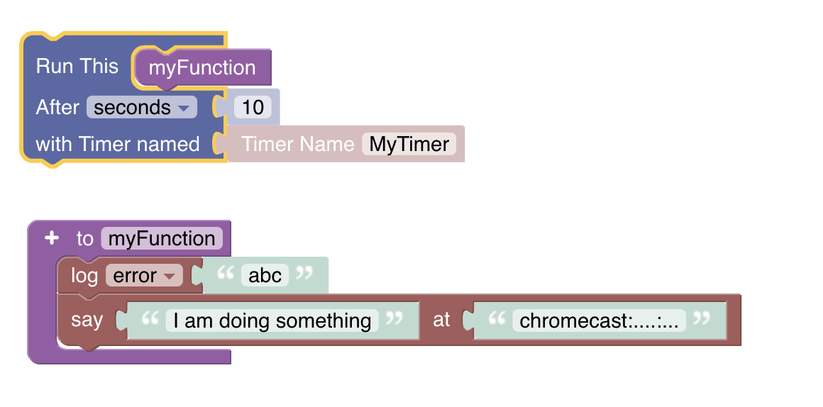

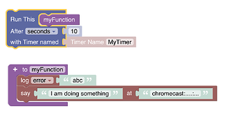

  • One thing that I’ve never really liked about how timers work in Rules DSL is how the lambda that gets passed to the Timer to run is defined inline. There are reason why one would want to do that given how Rules DSL works. But looking at the blocks here I wonder if it makes sense to follow that. Is there a way for the Run This block to present a list of the locally defined functions? Then the body of the Timer could be defined in a separate block which provides a bit of encapsulation which might make the code a little easier to read and maintain.
    Definitely keep the option to define the code inline too. I just want to also have the option to define the code in a separate function also.
  • I don’t think the third line will work where MyTimer is defined, though apparently it’s working for you. When I first started messing with it though that exact construction wouldn’t work for me. The very first time the rule runs, this.MyTimer won’t even exist. When a variable doesn’t exist its undefined, not null. I think the test needs to be this.MyTimer = (this.MyTimer === undefined) ? null : this.MyTimer; That means if the variable doesn’t exist, set it to null, otherwise leave it alone.

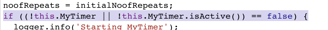

  • When comparing to undefined or null use the identity operator (=== or !==).
  • In JavaScript null and undefined are considered falsy. So the test to see if the Timer is active could be reduced to
    if( !this.MyTimer || !this.MyTimer.isActive() ) {
    The or operator fails fast. As soon as one of the operands evaluates to true it returns true. So if this.MyTimer is null it will be treated as false and the negate operator ! will convert that to true. Only if the Timer exists will isActive() be called. I don’t know if there is a Blockly reason why the current more complex construction is used here. If possible though it would be good to condense the code when possible.
  • Be consistent in the use of ending semicolons. There are several lines that are missing them.
Everything else looks reasonable to me.

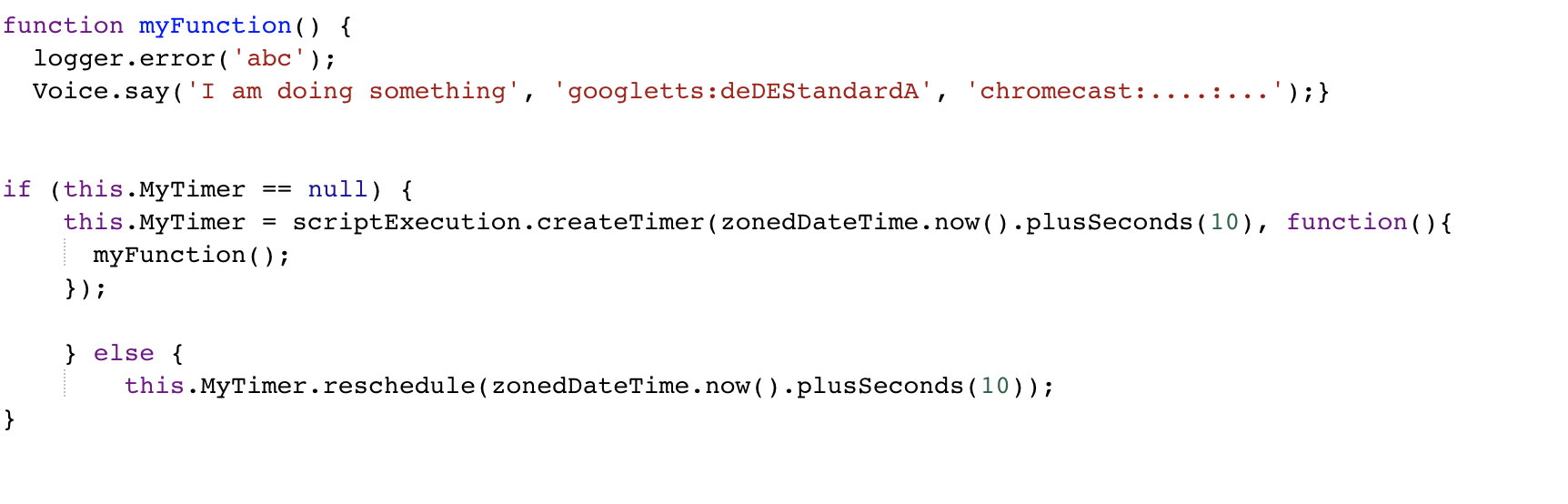

re 1: Regarding the anonymous block execution block: I guess the challenge would be here that the code that would have to be generated had to generate a function that had to named uniquely and not only that had to be put >outside< the code. This is probably really tough in blockly (technically the inner part block set is given to the outer part and >I< have to compose them together. The other option though is to define a function and then call that function within that block which works out of box and looks much cleaner (thanks for the idea - I wouldn’t have had this idea):
re 2: ok, I’ll change it to add “undefined” but I thing we need to say: “if it is different from null or undefined, keep it, otherwise set it to null”, i.e. the boolean inversion then is
this.MyTimer = ( this.MyTimer === undefined || this.myTimer ===null) ? null : this.MyTimer;
re 3: poor ol’ Java guys keep forgetting about the triple = … I will amend this
re 4:
That’s neat - the reason is me not blockly :wink: → So this
((this.MyTimer !== null) ? this.MyTimer.isActive() : false) == false
becomes this
re 5: semicolons → thanks for noting that. I already had cleaned up some of them (and also change string concatenation to js string interpolation in the code) but I now did again a thorough screening of the code. I am in favour of eliminating them but note that some of the code is standard blockly (like the one with the string concatenation or variable assignment) where I cannot change that.

If it’s different from null we absolutely fo not want to set it to null. If we do that we will lose the handle on the Timer created the last time the script was run so we won’t be able to reschedule or cancel.
On-the-other-hand, if it’s already null (which is what your code says counter to the sentence) why reset it to null?
Maybe we need to step back a moment on what this line is supposed to do.
this.myTimer = means create a variable named “this.myTimer” and set it to the result of the expression following the “=”, or if the variable does exist, set it to the result of the expression following the “=”.
No matter what, this.myTimer will exist as a variable after this line of code. Therefore only the very first time the rule runs after it’s loaded will `this.myTimer === undefined" be true.
Now the question is what does the expression evaluate to? I propose
( this.myTimer === undefined) ? null : this.myTimer
The very first time the script runs this.myTimer gets initialized to null. From that point on, this.myTimer gets set to what ever it is already assigned to. If it’s null, it will remain null. If it’s pointing to an active or even an expired timer, it will remain pointing to that same timer.
At a high level the expression is saying: if the variable doesn’t exist, initialize it to null, otherwise do nothing.

function arguments
By any chance, does it work with arguments?
As you can see in the following post blockly has a rather uncommon approach of parameters of a function which is basically a “no” to your question as a function doesn’t support local variables.
https://oucc.uk/index.php?action=content&id=47
Initialization
If it’s different from null we absolutely fo not want to set it to null .
I agree which is why I did it that way:
this.MyTimer=(this.MyTimer === undefined || this.MyTimer === null) ? null : this.MyTimer
which is the same like
this.MyTimer=(this.MyTimer !=== undefined && this.MyTimer !=== null) ? this.MyTimer : null
→ If the timer is null or undefined then set it to null, otherwise keep the value. With an if-statement I could have omitted the the assignment of the original value but the ternary operator doesn’t allow that. However, I find the latter more concise in the code or would you prefer an if like so?
if (this.MyTimer === undefined) {
  this.myTimer = null
Maybe this more clearer even when it was three lines line or we just format it to be a one-liner
 if (this.MyTimer === undefined) { this.myTimer = null}
I think we should go for the if-one liner, shouldn’t we?

It’s that last part I’m objecting to. If it’s already null there is no reason to set it to null again. Really, the only time we need to do anything special is when it’s undefined. So there is no reason to test for both undefined and `null’. It’s redundant.
I’ve only used the ternary operator in the past but it the if statement looks a bit more concise in what it does. I’m not too concerned about it taking up three lines. Stylistically I’d prefer that to the one liner if.
One thing the ternary operator has going for it is it explicitly shows what’s going on, but as you note, it’s got a redundant assignment. So I think I prefer the if statement best of all. But it’s not a strong preference.
Personally I like it on three lines. It’s easier for me to read. But looking at style guides a one liner if statement seems to be OK. Though they tend to be without the curly brackets.
if(this.myTimer === undefined) this.myTimer = null;
