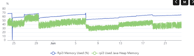

Situation: Running OH4M3 on a 6+ year old Rpi3b with zram and openhabian and occasionally struggle with memory/logging. Just trying to make it last :wink:. First 16MB is an absurd (IMO) amount of logging. From google 1 MB is 500 pages. My current OH log file is 2KB after 17 days. Most OPs with problems maybe post 20-100KB at most. And the frontail is a page or two? Anyway I don’t know if reducing is going to help. What I have tried to do was reduce production.
  1. First I’m firmly in the WARN for events camp. That shuts that log off. If there is a concern or you are looking for something you can use the developer tools-side bar and stream events right from the UI.
  2. I have made liberal use of the Regex filter. Some bindings are overly verbose and repetitive on messages that really do not indicate a problem. I also use the startup trigger policy so get a new log on startup and usually delete the old one unless I’m saving it for something.
  3. Moved all binding except Zwave and the Systeminfo over to my Rpi4 (Use remoteOH to get the info off the Rpi3.)
  4. Since I have never unpacked a .gz log in 6 years, I dug into the log rotate routines to save just the current log and one uncompressed backup on all the logs (syslog, auth, etc,)
  5. My most recent effort was reduce mapdb to just the items that were not in rrd4j. It had somehow grown to 27MB, but is now 33KB after 10 days.
My goal is to restart OH with the monthly (ish) milestone releases. Hopefully with the latest changes I’ll make it. Last restart was June 6.
