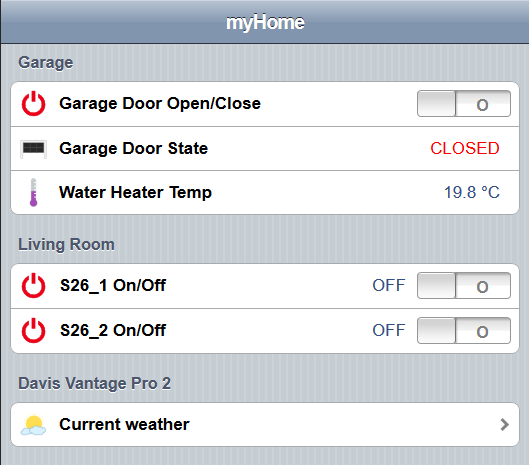

I cleaned up my openHAB by deleting the thing created in PaperUI and any references to it in the items and sitemap and now it is working. Visual Studio Code is still showing a syntax error in this part of the thing file, “mqtt:topic:nodemcu1” but it is working. The temperature is low because the sensor is not in the water heater yet and it’s just showing ambient temperature.
