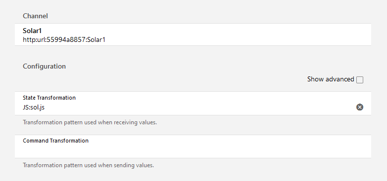

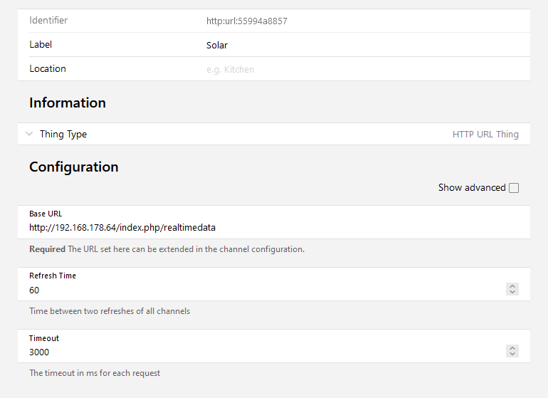

I’m using OH3 and have created an HTTP thing
I have created a Channel with a Transformation
I have installed REGEX and JS Transformations and in the Transformation folder i have wrote this :
(function(i) {
    var re = new RegExp("<td>.\d+.W.<\/td></td>");
    var out = i.match(re)[1];
    return parseFloat(out.replace(',', '.'));
})(input)
But i do net get the values i need, the error is:
Executing transformation ChannelStateTransformation{pattern=‘sol.js’, serviceName=‘JS’} failed: An error occurred while executing script. TypeError: Cannot get property “1” of null in at line number 3
I understand the error means that Regex do not find a value, but i’m not able to solve it.
Could you help me?

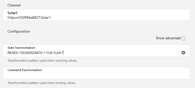

Thank you, I will try. I already have a dummy item and i get the entire HTML code in that.
But where should i put the
REGEX:.*502000026870-1.*(\d+)\sW.*
Directly in the Channel? like this:
Did you try it? Yes, that’s where it goes.
Yes it works, Thank you
Small detail if someone reads this later, there was a ? Missing, it should be:
REGEX:.502000026870-1.?(\d+)\sW.*`
