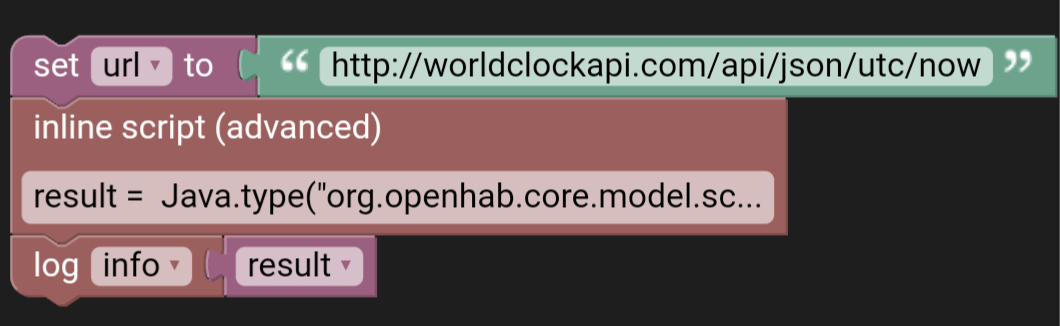

@JustinG : or what about just one single block of inline code:
Screenshot_20231209-072759
The inline code is:
result =  Java.type("org.openhab.core.model.script.actions.HTTP").sendHttpGetRequest(url, 5000)
That works too for getting the entire contents of the web page into Blockly. That still doesn’t extract the one value of interest. Whether it is more or less appropriate in this case depends on what the rule is expected to do, how the rule is triggered to run, and whether this information is also wanted anywhere else in another rule or the UI.
