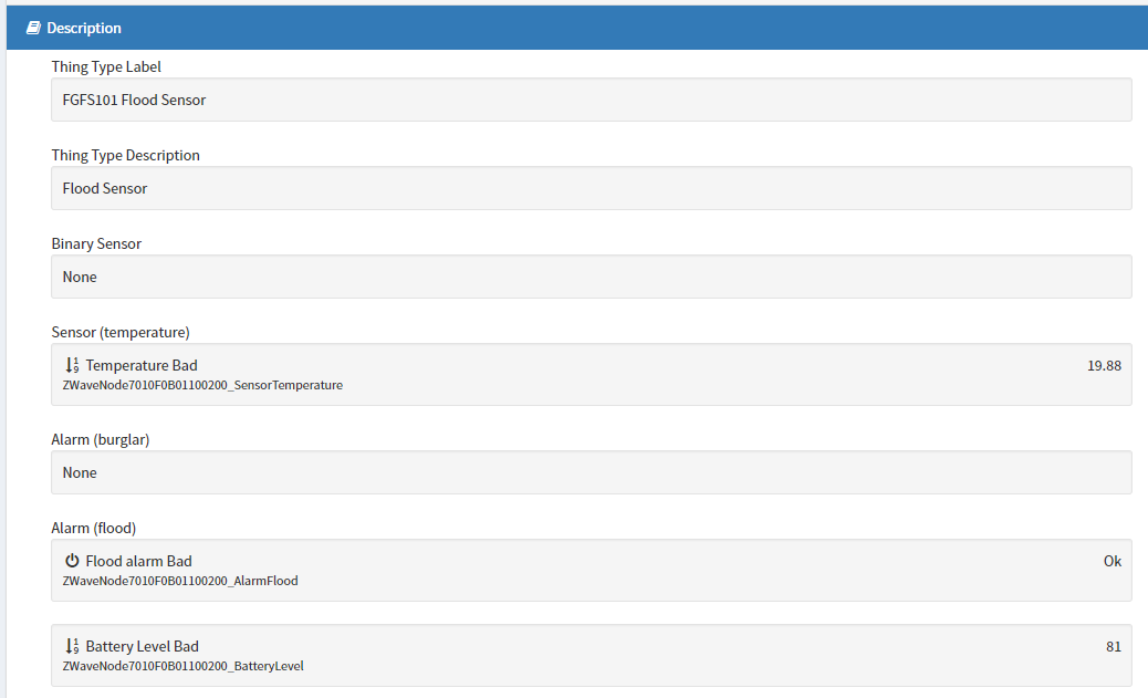

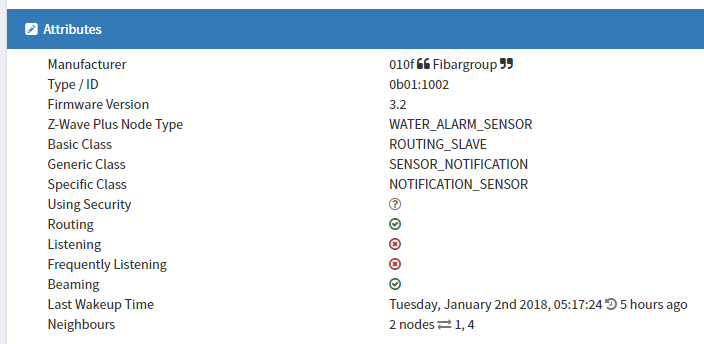

  • Issue of the topic: Since the update to the newest openHab Version, lots of sensors have extreme unrealistic values like 390 degree Celsius. These values stay for some minutes up to some hours. These items were added via the configuration.
    2018-01-01 12:32:06.063 [vent.ItemStateChangedEvent] - ZWaveNode7010F0B01100200_SensorTemperature changed from 20.17 to 390.0
The sensor from the example:

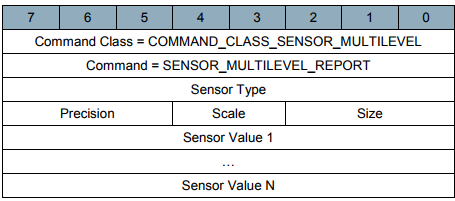

So, hand decoding the following message, which is the raw data from the message you posted above -:
2018-01-03 14:51:56.724 [DEBUG] [ve.internal.protocol.ZWaveController] - Process Message = 01 0C 00 04 00 0A 06 31 05 01 0A 02 03 C5
The command definition is as follows -:
31 = command class (sensor multilevel)
05 = command (report)
01 = sensor type (temperature)
0A = size=2, scale=1 (degF), precision=0
0203 = value (515)
Converting 515 with precision 0 is still 515. Scale = 1 (F), converting this to C is 268.
So unless I missed something, it looks to me like the binding is correctly interpreting the data. Either the sensor send the data incorrectly, or the message got corrupted somewhere. We can say that it was correctly passed from the controller to the binding as the checksum on the packet is ok.
