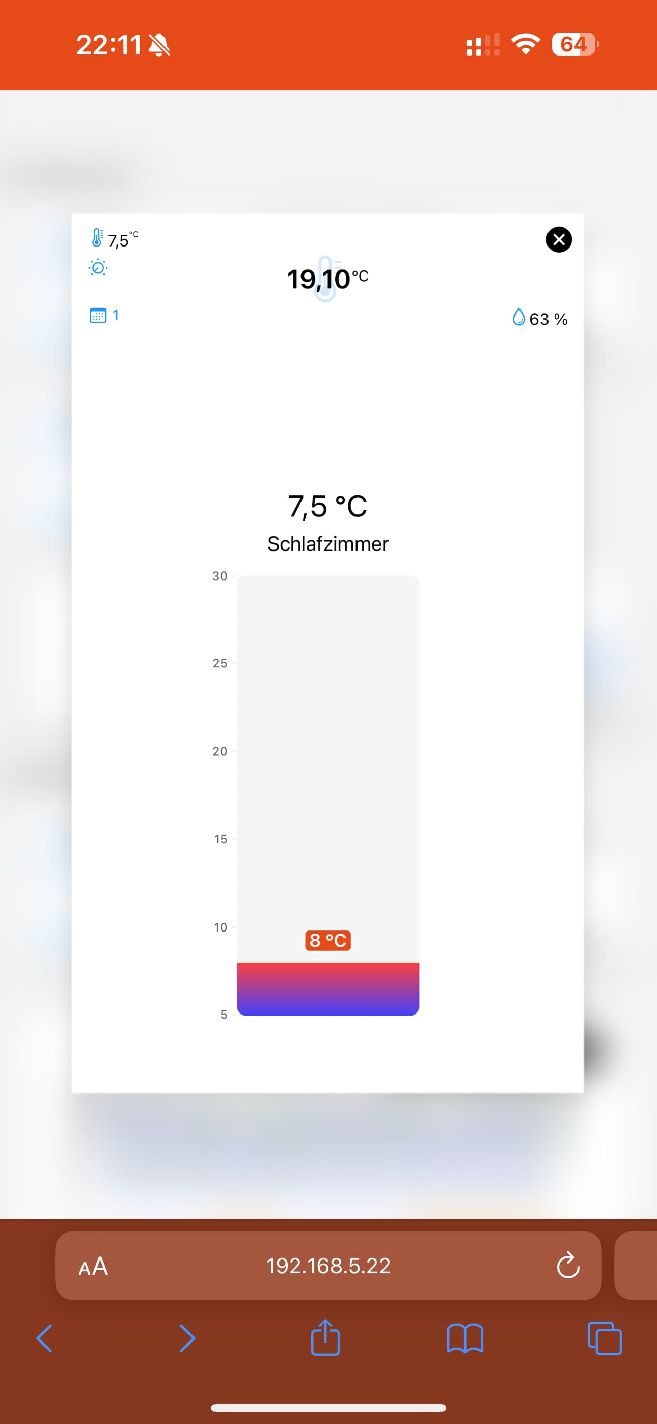

I use a f7-expandable card to set the temperature for my thermostat.
By moving up/down the slider, the temperature can be set.
The swipeToClose parameter is enabled, which causes some issue when decreasing the temperature.
In this case, the card size degrease which makes use of the slider less user friendly.
Is it possible to exclude the slider from “swipe to close” feature?

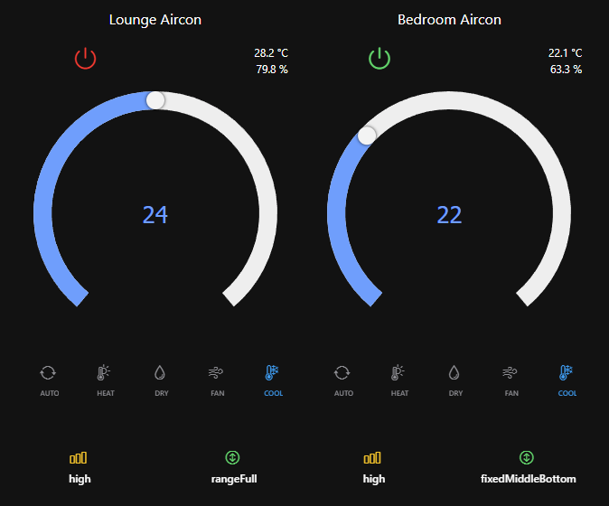

another option would be to use a oh-knob

As far as I understood your reply, the issue is exactly the opposite.
The issue is with the gesture used to move down the slider.
By moving down the slider, not only the slider value gets decreased, but also the Card size itself gets decreased as in my screenshot.
I was looking for an option to ignore the SwipToClose gesture in the Slider area.
Moving down the slider should not trigger the SwipeToClose function.
Hope this makes it more clear :slight_smile:
@denominator - I used the oh-knob before, but want a controller style similar to Apple Home App. :wink:
