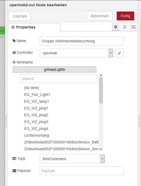

Here the openhab2-out item (which imho causes the trouble):

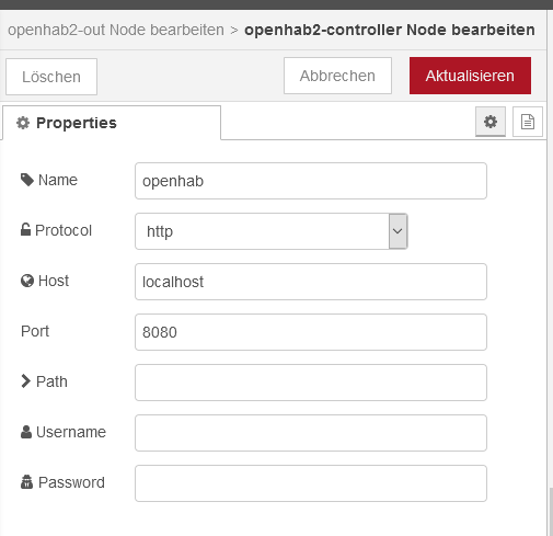

and the openhab2 connection itself:

Can you run a network sniffer so that we can check the exact content of the request that is being sent to the REST API ?
The request that is being described in the error message does not show the content-type of the request which needs to be text/plain.
Perhaps putting the REST APi into DEBUG or TRACE log mode would help to see, at least, when OH thinks it receives.

BUT your very first assumption was correct: it was an issue on the rednode side.
So in case someone stumbles over the same problem:
It was a simple error: ON msg (which text box is described as “mqtt msg” does NOT refer to mqtt only, but to every output. ON text is just a simple ui text message in node red and has nothing to do with the actual nessage send to openhab.
long story short: write ON and OFF in the mqqt payload field and everything is fine.
the “1” send as payload was a debugging error on my side
