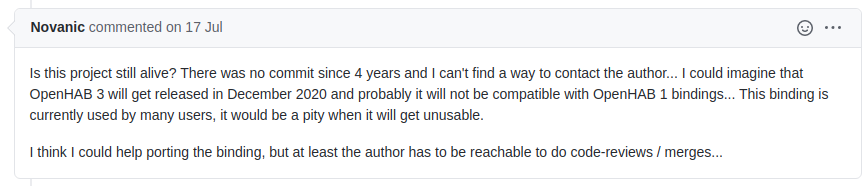

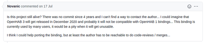

Found this: Push to OHv2 · Issue #44 · gitbock/fritzboxtr064 · GitHub
You read correctly
Maybe contact the author as he may not even have a fritzbox anymore.
The above link expands to:
Yep looks like a dead end
Some people have forked it so maybe someone will take it on.
Offering a new German Fritzbox 7490 as bounty to move/migrate/program binding to v2.
Looks like @J-N-K is already working on it.
