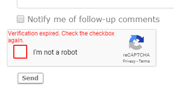

Looks like there is a problem with the captcha:

I just noticed an error on the screen here at least - it seems that the comments system, which has not been updated for a while, is not compatible with the latest PHP. I’ve found a fix, but need to see how to install it.
Ok, it should now be fixed. Let me know if you’re still having problems with it.
Captcha seems to now have an invisible mode (or maybe it’s just not working - but I did read it can run invisibly, so as long as I don’t start getting SPAM, I’ll leave it :slight_smile: ).
