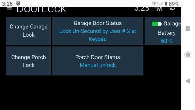

I have a Z-Wave door lock (914TRL Touchpad Electronic Deadbolt) that started sending phantom messages about a week ago. If I command it to either Lock or Unlock the lock performs the correct operation and reports the the proper message. Like {“type”:“24”,“value”:“1”} when commanded to Lock and {“type”:“25”,“value”:“1”} when commanded to Unlock. But then a few seconds later it would send {“type”:“18”,“value”:“0”} which means:
“Secured at Keypad - Successful (Fully extended)” but nobody touched the keypad. The timing might be 2 or 3 seconds but some times longer, as much as 12 seconds. It sends the type 18 for both lock and unlock commands.

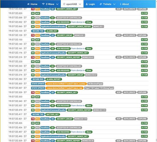

That didn’t fix the problem though it changed it from reporting {“type”:“18”,“value”:“0”} to reporting {“type”:“0”,“value”:“0”}. Again when given the command Lock or Unlock it performs the correct action and sends the correct report but a few seconds later {“type”:“0”,“value”:“0”}. Note type 0 is not in the list of alarm types.

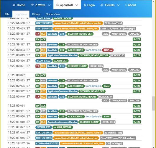

I have been spending a lot of time going through openhab.log for this device (NODE 27). There is a lot I don’t understand with Z-Wave but I found some interesting things. If I initiate a Lock Change (Lock or Unlock but Unlock in this case) I will see a burst that includes “alarm_raw to {“type”:“25”,“value”:“1”}” which means “Lock Un-Secured by Controller – Successful (Fully retracted)” Then the burst ends.
Then few seconds later another burst happens and includes “alarm_raw to {“type”:“21”,“value”:“0”}” which means " Lock Secured using Keyed cylinder or inside thumb-turn ". But nobody is at the lock to cause this and the lock remains Unlocked. One peculiarity is the “value” is 0 where as the documentation says for this message the “value” should be 1.
Also, a few lines before this I see:
ALARM report - 21 = 0 and
Alarm Type = WATER_QUALITY (21).
Why the heck is a lock reporting WATER_QUALITY ?
I have included the log below.
The first line at 2020-07-24 09:12:59.586 is the start of the sequence.
The alarm_raw type 25 is at time 09:13:02.559.
Then the WATER_QUALITY is at time 09:13:07.961. Over 5 seconds later.
Here is the log:

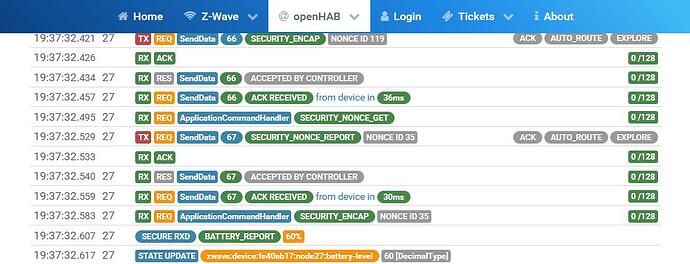

@chris finds unfiltered logs are needed for troubleshooting. The log viewer should help the bleary eyes :wink:
https://www.cd-jackson.com/index.php/openhab/zwave-log-viewer
Well, I started out using that but couldn’t find anything to help so I started using the viewer that has been added to http://192.168.1.115:9001/. That is where I found s lot more NODE 27 information.
Below is an unfiltered section from Chris’s log viewer.
RX REQ ApplicationCommandHandler SENSOR_MULTI_LEVEL_REPORT TEMPERATURE=42 0 /128
01 0C 00 04 08 05 06 31 05 01 2A 03 0C EC
10:50:47.806	5
01 0C 00 04 00 05 06 31 05 01 2A 03 0C E4
10:50:47.824	5
STATE UPDATE zwave:device:fe40ab17:node5:sensor_temperature 78 °F [QuantityType]
10:50:47.861	5
11:12:08.845	5
01 0C 00 04 08 05 06 31 05 01 2A 03 11 F1
11:12:08.871	5
01 0C 00 04 00 05 06 31 05 01 2A 03 11 F9
11:12:08.892	5
STATE UPDATE zwave:device:fe40ab17:node5:sensor_temperature 78.5 °F [QuantityType]
11:12:08.940	5
11:13:01.180	27
TX REQ SendData 121 SECURITY_NONCE_GET  ACK AUTO_ROUTE EXPLORE
01 09 00 13 1B 02 98 40 25 79 78
11:13:01.186
RX ACK 0 /128
06
11:13:01.208	27
RX RES SendData 121 ACCEPTED BY CONTROLLER 0 /128
01 04 01 13 01 E8
11:13:02.440	27
RX REQ SendData 121 ACK RECEIVED from device in 1260ms 0 /128
01 07 00 13 79 00 00 7E EC
11:13:02.459	27
RX REQ ApplicationCommandHandler SECURITY_NONCE_REPORT NONCE ID 89 0 /128
01 10 00 04 00 1B 0A 98 80 59 C2 33 79 62 5F BA F3 47
11:13:02.540	27
SECURE TXD DOOR_LOCK_GET
62 02
11:13:02.551	27
TX REQ SendData 122 SECURITY_ENCAP NONCE ID 89  ACK AUTO_ROUTE EXPLORE
01 1D 00 13 1B 16 98 81 96 CC DB 73 4F E2 9F 67 35 28 F7 59 D9 C3 EA 53 31 8E A2 1E 25 7A 0E
11:13:02.557
RX ACK 0 /128
06
11:13:02.565	27
RX RES SendData 122 ACCEPTED BY CONTROLLER 0 /128
01 04 01 13 01 E8
11:13:02.589	27
RX REQ SendData 122 ACK RECEIVED from device in 38ms 0 /128
01 07 00 13 7A 00 00 02 93
11:13:02.628	27
RX REQ ApplicationCommandHandler SECURITY_NONCE_GET 0 /128
01 08 00 04 00 1B 02 98 40 32
11:13:02.665	27
TX REQ SendData 123 SECURITY_NONCE_REPORT NONCE ID 51  ACK AUTO_ROUTE EXPLORE
01 11 00 13 1B 0A 98 80 33 8D 2D 02 66 8C 27 87 25 7B 71
11:13:02.671
RX ACK 0 /128
06
11:13:02.678	27
RX RES SendData 123 ACCEPTED BY CONTROLLER 0 /128
01 04 01 13 01 E8
11:13:02.696	27
RX REQ SendData 123 ACK RECEIVED from device in 31ms 0 /128
01 07 00 13 7B 00 00 02 92
11:13:02.727	27
RX REQ ApplicationCommandHandler SECURITY_ENCAP NONCE ID 51 0 /128
01 21 00 04 00 1B 1B 98 81 A0 A5 07 57 30 2B D2 B8 0B 21 23 2B 6F C9 6C 1A 33 B7 47 D9 BD 21 6A D3 10 3A
11:13:02.758	27
SECURE RXD DOOR_LOCK_REPORT
62 03 00 00 02 FE FE
11:13:02.771	27
STATE UPDATE zwave:device:fe40ab17:node27:lock_door OFF [OnOffType]
11:13:02.809	27
TX REQ SendData 124 SECURITY_NONCE_GET  ACK AUTO_ROUTE EXPLORE
01 09 00 13 1B 02 98 40 25 7C 7D
11:13:02.814
RX ACK 0 /128
06
11:13:02.822	27
RX RES SendData 124 ACCEPTED BY CONTROLLER 0 /128
01 04 01 13 01 E8
11:13:02.839	27
RX REQ SendData 124 ACK RECEIVED from device in 30ms 0 /128
01 07 00 13 7C 00 00 03 94
11:13:02.854	27
RX REQ ApplicationCommandHandler SECURITY_NONCE_REPORT NONCE ID 190 0 /128
01 10 00 04 00 1B 0A 98 80 BE 1C 8E 41 97 62 5D DF F8
11:13:02.908	27
SECURE TXD ALARM_GET
71 04 15
11:13:02.915	27
TX REQ SendData 125 SECURITY_ENCAP NONCE ID 190  ACK AUTO_ROUTE EXPLORE
01 1E 00 13 1B 17 98 81 36 60 F4 6C A9 98 13 38 73 7C AC AB BE 21 24 D0 A5 01 AB 72 05 25 7D 70
11:13:02.921
RX ACK 0 /128
06
11:13:02.928	27
RX RES SendData 125 ACCEPTED BY CONTROLLER 0 /128
01 04 01 13 01 E8
11:13:02.951	27
RX REQ SendData 125 ACK RECEIVED from device in 36ms 0 /128
01 07 00 13 7D 00 00 03 95
11:13:02.966	27
11:13:03.010	27
TX REQ SendData 126 SECURITY_NONCE_REPORT NONCE ID 10  ACK AUTO_ROUTE EXPLORE
01 11 00 13 1B 0A 98 80 0A 0B 62 AF B5 9F F2 89 25 7E 32
11:13:03.015
RX ACK 0 /128
06
11:13:03.022	27
RX RES SendData 126 ACCEPTED BY CONTROLLER 0 /128
01 04 01 13 01 E8
11:13:03.041	27
RX REQ SendData 126 ACK RECEIVED from device in 31ms 0 /128
01 07 00 13 7E 00 00 02 97
11:13:03.067	27
RX REQ ApplicationCommandHandler SECURITY_ENCAP NONCE ID 10 0 /128
01 1E 00 04 00 1B 18 98 81 F8 06 3D B1 AB 3B 50 C4 05 8F C7 EB 5A 0A 19 65 94 A5 CF 61 61 AD 50
11:13:03.089	27
SECURE RXD ALARM_REPORT
71 05 15 00
11:13:03.101	27
STATE UPDATE zwave:device:fe40ab17:node27:alarm_number 21 [DecimalType]
11:13:03.107	27
STATE UPDATE zwave:device:fe40ab17:node27:alarm_raw {"type":"21","value":"0"} [StringType]
11:43:01.191	27
TX REQ SendData 127 SECURITY_NONCE_GET  ACK AUTO_ROUTE EXPLORE
01 09 00 13 1B 02 98 40 25 7F 7E
11:43:01.197
RX ACK 0 /128
06
11:43:01.205	27
RX RES SendData 127 ACCEPTED BY CONTROLLER 0 /128
01 04 01 13 01 E8
11:43:02.465	27
RX REQ SendData 127 ACK RECEIVED from device in 1274ms 0 /128
01 07 00 13 7F 00 00 7F EB
11:43:02.494	27
RX REQ ApplicationCommandHandler SECURITY_NONCE_REPORT NONCE ID 163 0 /128
01 10 00 04 00 1B 0A 98 80 A3 B9 FF DC D6 36 37 86 8A
11:43:02.542	27
62 02
11:43:02.548	27
TX REQ SendData 128 SECURITY_ENCAP NONCE ID 163  ACK AUTO_ROUTE EXPLORE
01 1D 00 13 1B 16 98 81 EF 5C 1D 46 6D 23 12 86 26 98 96 A3 43 49 76 D0 5C 84 F1 42 25 80 3E
11:43:02.553
RX ACK 0 /128
06
11:43:02.560	27
RX RES SendData 128 ACCEPTED BY CONTROLLER 0 /128
01 04 01 13 01 E8
11:43:02.582	27
RX REQ SendData 128 ACK RECEIVED from device in 34ms 0 /128
01 07 00 13 80 00 00 02 69
11:43:02.622	27
11:43:02.666	27
TX REQ SendData 129 SECURITY_NONCE_REPORT NONCE ID 56  ACK AUTO_ROUTE EXPLORE
01 11 00 13 1B 0A 98 80 38 41 E8 DC 14 52 A1 6F 25 81 95
11:43:02.672
RX ACK 0 /128
06
11:43:02.678	27
RX RES SendData 129 ACCEPTED BY CONTROLLER 0 /128
01 04 01 13 01 E8
11:43:02.698	27
RX REQ SendData 129 ACK RECEIVED from device in 32ms 0 /128
01 07 00 13 81 00 00 03 69
11:43:02.725	27
RX REQ ApplicationCommandHandler SECURITY_ENCAP NONCE ID 56 0 /128
01 21 00 04 00 1B 1B 98 81 1D 22 E5 B7 8B 65 31 73 DA 95 03 A0 26 EF 16 E9 38 FB 93 1C 57 D9 99 A0 20 03
11:43:02.746	27
11:43:02.757	27
11:43:02.788	27
TX REQ SendData 130 SECURITY_NONCE_GET  ACK AUTO_ROUTE EXPLORE
01 09 00 13 1B 02 98 40 25 82 83
11:43:02.792
RX ACK 0 /128
06
11:43:02.799	27
RX RES SendData 130 ACCEPTED BY CONTROLLER 0 /128
01 04 01 13 01 E8
11:43:02.817	27
RX REQ SendData 130 ACK RECEIVED from device in 29ms 0 /128
01 07 00 13 82 00 00 02 6B
11:43:02.831	27
RX REQ ApplicationCommandHandler SECURITY_NONCE_REPORT NONCE ID 139 0 /128
01 10 00 04 00 1B 0A 98 80 8B 32 46 49 FD 4A 37 FF 2B
11:43:02.873	27
71 04 15
11:43:02.878	27
TX REQ SendData 131 SECURITY_ENCAP NONCE ID 139  ACK AUTO_ROUTE EXPLORE
01 1E 00 13 1B 17 98 81 6B 1B 34 7E 16 76 61 EE A1 24 7E 9B 8B 61 8F A6 BF 17 A7 1F 42 25 83 65
11:43:02.884
RX ACK 0 /128
06
11:43:02.892	27
RX RES SendData 131 ACCEPTED BY CONTROLLER 0 /128
01 04 01 13 01 E8
11:43:02.913	27
RX REQ SendData 131 ACK RECEIVED from device in 35ms 0 /128
01 07 00 13 83 00 00 02 6A
11:43:02.928	27
11:43:02.972	27
TX REQ SendData 132 SECURITY_NONCE_REPORT NONCE ID 46  ACK AUTO_ROUTE EXPLORE
01 11 00 13 1B 0A 98 80 2E 8C D6 33 85 CE 78 A8 25 84 89
11:43:02.977
RX ACK 0 /128
06
11:43:02.985	27
RX RES SendData 132 ACCEPTED BY CONTROLLER 0 /128
01 04 01 13 01 E8
11:43:03.004	27
RX REQ SendData 132 ACK RECEIVED from device in 32ms 0 /128
01 07 00 13 84 00 00 02 6D
11:43:03.028	27
RX REQ ApplicationCommandHandler SECURITY_ENCAP NONCE ID 46 0 /128
01 1E 00 04 00 1B 18 98 81 59 3F 57 C3 34 38 DE 5F 92 EC C5 52 2E 2E 55 94 60 B1 28 5A 0B F7 F7
11:43:03.050	27
71 05 15 00
11:43:03.062	27
11:43:03.067	27
12:13:01.185	27
TX REQ SendData 133 SECURITY_NONCE_GET  ACK AUTO_ROUTE EXPLORE
01 09 00 13 1B 02 98 40 25 85 84
12:13:01.190
RX ACK 0 /128
06
12:13:01.200	27
RX RES SendData 133 ACCEPTED BY CONTROLLER 0 /128
01 04 01 13 01 E8
12:13:02.461	27
RX REQ SendData 133 ACK RECEIVED from device in 1276ms 0 /128
01 07 00 13 85 00 00 7F 11
12:13:02.475	27
RX REQ ApplicationCommandHandler SECURITY_NONCE_REPORT NONCE ID 18 0 /128
01 10 00 04 00 1B 0A 98 80 12 EF 1F 1C 78 3B B7 C8 20
12:13:02.548	27
62 02
12:13:02.560	27
TX REQ SendData 134 SECURITY_ENCAP NONCE ID 18  ACK AUTO_ROUTE EXPLORE
01 1D 00 13 1B 16 98 81 A8 97 3E C6 D1 FC 30 0D 7C 7C 16 12 76 90 61 1E DC 16 84 F0 25 86 B2
12:13:02.568
RX ACK 0 /128
06
12:13:02.576	27
RX RES SendData 134 ACCEPTED BY CONTROLLER 0 /128
01 04 01 13 01 E8
12:13:02.602	27
RX REQ SendData 134 ACK RECEIVED from device in 42ms 0 /128
01 07 00 13 86 00 00 03 6E
12:13:02.638	27
12:13:02.676	27
TX REQ SendData 135 SECURITY_NONCE_REPORT NONCE ID 168  ACK AUTO_ROUTE EXPLORE
01 11 00 13 1B 0A 98 80 A8 F8 65 3B 57 CD 2D 8D 25 87 62
12:13:02.683
RX ACK 0 /128
06
12:13:02.691	27
RX RES SendData 135 ACCEPTED BY CONTROLLER 0 /128
01 04 01 13 01 E8
12:13:02.710	27
RX REQ SendData 135 ACK RECEIVED from device in 34ms 0 /128
01 07 00 13 87 00 00 02 6E
12:13:02.738	27
RX REQ ApplicationCommandHandler SECURITY_ENCAP NONCE ID 168 0 /128
01 21 00 04 00 1B 1B 98 81 4D A2 66 09 06 22 AE F7 92 92 4F DE 0A 45 E0 66 A8 1E AB 7E 46 14 E8 A0 6C 73
12:13:02.766	27
12:13:02.782	27
12:13:02.823	27
TX REQ SendData 136 SECURITY_NONCE_GET  ACK AUTO_ROUTE EXPLORE
01 09 00 13 1B 02 98 40 25 88 89
12:13:02.827
RX ACK 0 /128
06
12:13:02.835	27
RX RES SendData 136 ACCEPTED BY CONTROLLER 0 /128
01 04 01 13 01 E8
12:13:02.851	27
RX REQ SendData 136 ACK RECEIVED from device in 28ms 0 /128
01 07 00 13 88 00 00 03 60
12:13:02.866	27
RX REQ ApplicationCommandHandler SECURITY_NONCE_REPORT NONCE ID 147 0 /128
01 10 00 04 00 1B 0A 98 80 93 68 9B 7E 6C 76 5F 52 EB
12:13:02.923	27
71 04 15
12:13:02.930	27
TX REQ SendData 137 SECURITY_ENCAP NONCE ID 147  ACK AUTO_ROUTE EXPLORE
01 1E 00 13 1B 17 98 81 FB 4F 6B 7B 46 45 02 92 D3 84 31 19 93 A7 FA D1 EC 7E 11 C6 EE 25 89 B7
12:13:02.937
RX ACK 0 /128
06
12:13:02.948	27
RX RES SendData 137 ACCEPTED BY CONTROLLER 0 /128
01 04 01 13 01 E8
12:13:02.966	27
RX REQ SendData 137 ACK RECEIVED from device in 36ms 0 /128
01 07 00 13 89 00 00 02 60
12:13:02.982	27
12:13:03.018	27
TX REQ SendData 138 SECURITY_NONCE_REPORT NONCE ID 162  ACK AUTO_ROUTE EXPLORE
01 11 00 13 1B 0A 98 80 A2 25 C9 22 24 91 89 43 25 8A 48
12:13:03.022
RX ACK 0 /128
06
12:13:03.030	27
RX RES SendData 138 ACCEPTED BY CONTROLLER 0 /128
01 04 01 13 01 E8
12:13:03.048	27
RX REQ SendData 138 ACK RECEIVED from device in 30ms 0 /128
01 07 00 13 8A 00 00 02 63
12:13:03.074	27
RX REQ ApplicationCommandHandler SECURITY_ENCAP NONCE ID 162 0 /128
01 1E 00 04 00 1B 18 98 81 45 0B F9 92 6B BE 95 36 94 15 27 F8 19 A2 BC C1 9E 6A E4 25 A5 1E BA
12:13:03.099	27
71 05 15 00
12:13:03.114	27
12:13:03.119	27
12:36:21.560	26
01 08 00 04 00 1A 02 98 40 33
12:36:21.594	26
TX REQ SendData 139 SECURITY_NONCE_REPORT NONCE ID 142  ACK AUTO_ROUTE EXPLORE
01 11 00 13 1A 0A 98 80 8E F5 7C D8 C7 0E 5F 30 25 8B 22
12:36:21.600
RX ACK 0 /128
06
12:36:21.607	26
RX RES SendData 139 ACCEPTED BY CONTROLLER 0 /128
01 04 01 13 01 E8
12:36:21.625	26
RX REQ SendData 139 ACK RECEIVED from device in 31ms 0 /128
01 07 00 13 8B 00 00 02 62
12:36:21.647	26
RX REQ ApplicationCommandHandler SECURITY_ENCAP NONCE ID 142 0 /128
01 1D 00 04 00 1A 17 98 81 B8 E8 98 38 98 B9 EB 86 7E 2C 73 46 8E 55 74 CC 3B 85 E7 7A 0A 63
12:36:21.665	26
SECURE RXD BATTERY_REPORT 92%
80 03 5C
12:43:01.172	27
TX REQ SendData 140 SECURITY_NONCE_GET  ACK AUTO_ROUTE EXPLORE
01 09 00 13 1B 02 98 40 25 8C 8D
12:43:01.178
RX ACK 0 /128
06
12:43:01.192	27
RX RES SendData 140 ACCEPTED BY CONTROLLER 0 /128
01 04 01 13 01 E8
12:43:02.416	27
RX REQ SendData 140 ACK RECEIVED from device in 1244ms 0 /128
01 07 00 13 8C 00 00 7C 1B
12:43:02.435	27
RX REQ ApplicationCommandHandler SECURITY_NONCE_REPORT NONCE ID 82 0 /128
01 10 00 04 00 1B 0A 98 80 52 0E 2F BA 04 82 34 27 BE
12:43:02.502	27
62 02
12:43:02.509	27
TX REQ SendData 141 SECURITY_ENCAP NONCE ID 82  ACK AUTO_ROUTE EXPLORE
01 1D 00 13 1B 16 98 81 AD 7F BB CB 3B 1A 86 DB BF 63 53 52 6E 69 65 D6 03 6E 71 A8 25 8D 4E
12:43:02.515
RX ACK 0 /128
06
12:43:02.522	27
RX RES SendData 141 ACCEPTED BY CONTROLLER 0 /128
01 04 01 13 01 E8
12:43:02.545	27
RX REQ SendData 141 ACK RECEIVED from device in 36ms 0 /128
01 07 00 13 8D 00 00 03 65
12:43:02.584	27
12:43:02.620	27
TX REQ SendData 142 SECURITY_NONCE_REPORT NONCE ID 19  ACK AUTO_ROUTE EXPLORE
01 11 00 13 1B 0A 98 80 13 11 34 0D A4 A0 58 6A 25 8E 52
12:43:02.625
RX ACK 0 /128
06
12:43:02.632	27
RX RES SendData 142 ACCEPTED BY CONTROLLER 0 /128
01 04 01 13 01 E8
12:43:02.650	27
RX REQ SendData 142 ACK RECEIVED from device in 30ms 0 /128
01 07 00 13 8E 00 00 02 67
12:43:02.677	27
RX REQ ApplicationCommandHandler SECURITY_ENCAP NONCE ID 19 0 /128
01 21 00 04 00 1B 1B 98 81 26 DE 1E 33 43 D6 9E 5F D4 E5 99 D9 7B 51 89 06 13 23 E9 6E 22 EB A1 19 2C 7C
12:43:02.697	27
12:43:02.709	27
12:43:02.739	27
TX REQ SendData 143 SECURITY_NONCE_GET  ACK AUTO_ROUTE EXPLORE
01 09 00 13 1B 02 98 40 25 8F 8E
12:43:02.742
RX ACK 0 /128
06
12:43:02.749	27
RX RES SendData 143 ACCEPTED BY CONTROLLER 0 /128
01 04 01 13 01 E8
12:43:02.766	27
RX REQ SendData 143 ACK RECEIVED from device in 27ms 0 /128
01 07 00 13 8F 00 00 02 66
12:43:02.780	27
RX REQ ApplicationCommandHandler SECURITY_NONCE_REPORT NONCE ID 108 0 /128
01 10 00 04 00 1B 0A 98 80 6C D5 40 0F 33 9E F2 24 6F
12:43:02.826	27
71 04 15

Well I have been doing a lot of experimenting with this door lock and drudging through untold openhab.logs. I wish I could find a key to deciphering the log.
Anyhow, I have found that the “false” reports occur both right after a command to change and also as the result of polling which seems to happen every 30 minutes. For a few days the false report was {“type”:“21”,“value”:“0”}” which means " Lock Secured using Keyed cylinder or inside thumb-turn.
Today I rebooted my RPi and now the false reports are {“type”:“19”,“value”:“0”}=“Un-Secured by User 0 at Keypad”.
Nobody was near the keypad.
Interestingly when I was getting the {“type”:“21”,“value”:“0”} reports, I could always find the text:
"ALARM report - 21 = 0 and
where the “21” matches the type 21.
Today I am getting:
ALARM report - 19 = 0
Alarm Type = PEST_CONTROL (19)
where the “19” matches the type 19.
What does a door lock have to do with WATER_QUALITY or PEST_CONTROL?
I think the solution to my problem is to ignore the reports right after commanding a change and all the polling reports.
I have no idea how to do that. Any suggestions?
Here is the log via
“tail -f /var/log/openhab2/openhab.log /var/log/openhab2/events.log”
The command to change the lock is at 14:16:25.621
The PEST_CONTROL is at 14:16:34.007
The {“type”:“19”,“value”:“0”} is at 14:16:34.020

I have attached a screen capture of Chris’s log. The {“type”.“25”,“value”.“1”} at time 15:22:55.665 is the one I need and it will get to the HABpanel display but then at 15:23:01.046 I get the {“type”:“22”,“value”.“0”} which overwrites the correct state. I need to find a way to detect that second {} and all subsequent ones (from polling) and stop them from updating the HABpanel display.
Either you have a very small network or that is a filtered log. @chris has said many times that a filtered log is useless for troubleshooting purposes.
These “raw” notifications are designed to be used in rules, so this is pretty easy. You need to create a virtual item - ie one that is not linked to a channel. You an then write a rule that receives these raw notifications, filters them as you like, and then updates the virtual item.
The following link might give you some ideas -:

I think I have a solution for this problem that works except for one situation.
I have attached a screen capture of my cellphone screen.
The first row is for this lock. The second is for my Yale lock.
I will summarize the Problem because sometimes long threads lose context:
I started using the lock_door channel to report the state of the lock.
I discovered that if the lock changed because of a manual operation
like turning the lever, the lock_door channel is not updated.
So I tried the alarm_raw channel. It reports the correct state
but then a few seconds later (or for every polling action)
it reports a bogus state. The bogus alarm_raw seems to report as:
“Lock Secured at Keypad – Successful (Fully extended)”
but with no user number {“type”:“18”,“value”:“0”}.
The Solution:
If I used Alarm_Raw the wrong state can be displayed so I created a Virtual item like Chris recommended.
Then I can choose which alarm_raw reports to use.
Thus I will not update Virtual item if alarm_raw is {“type”:“18”,“value”:“0”}.
However {“type”:“18”,“value”:“0”} is a valid value for when the Lock
button on the keypad is pressed without a user ID.
So in that case the Virtual display will not be updated to show:
This is the only case where the wrong state is displayed by the Virtual item.
If it is any consolation the door is locked when this happens.
If I could tell the difference between the bogus {“type”:“18”,“value”:“0”} and the valid one this problem could be corrected.
I just don’t have enough knowledge of the Z-Wave logs to solve this. I have included three image captures of the log when this is happening. With reference to the first image and time 19:30:10:569. That is when I pushed the Lock button of the keypad without entering a User ID. I believe the entire report ends at 19:30:10:694 where the {“type”:“18”,“value”:“0”} is reported. This is not the bogus report.
But I believe about 7 minutes later at 19:37:30:462 the bogus report starts. I don’t know what all those entries are telling us but at 19:37:32:307 I get the {“type”:“18”,“value”:“0”} which is a problem. (Note you might argue that this is a repeat of the last {“type”:“18”,“value”:“0”} but this sequence will come no matter what the last report was. If necessary I can provide other examples.)
