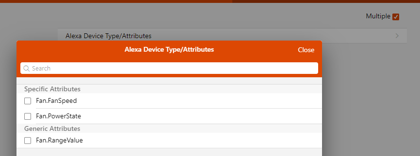

Have you tried to use the new metadata syntax?
You should use FanSpeed and PowerState to accomplish that. And if your device is a single endpoint, you can just model as Fan since both are default attributes for that device type.
Where do I set these? I have two items for the fan - the Office Fan Group and the office fan dimmer:
Do I do this on the dimmer, or just pick ‘fan’ on the group?
To set your group endpoint, set the Group item as Fan and your Dimmer item as FanSpeed and PowerState.
