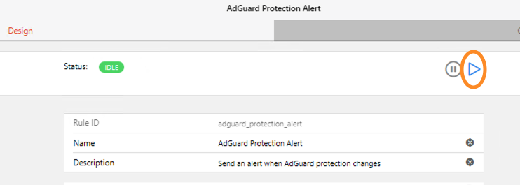

No additional trigger is required. Just click the run button on the Rule’s page and it will run the rule.
Note, if you depend on the event (e.g. event.itemName) or implicit variables (e.g. triggeringItemName) those will not be defined when running the rule manually.

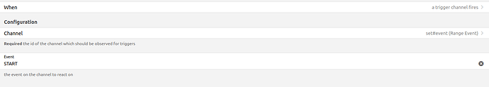

Updated with code. Does this appear correct?
So, I ran my sunset rule and the light did not go on (I can normally control this light on and off). What I’d like to happen is the act of pressing RUN acts like a TRUE trigger override to the WHEN condition to run the THEN clause and the light would go on. That would help me test the THEN part of the rule. Should the light have gone on? Or is my THEN clause shown here incorrect?

For that matter is the WHEN clause correct to turn a light on at sunset?

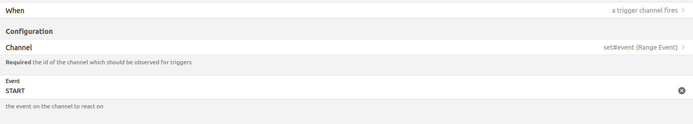

You would have the another rule for the sunset like the on you already have but change the channelUD TO:
channelUID: astro:sun:local:set#event
instead of rise and then change the command from:
      command: sendCommand(OFF)
to
      command: sendCommand(ON)
Also the type should be when the event is triggered otherwise the event won’t be triggered:
type: core.ChannelEventTrigger
I think that will work and should also work when you press the run button as suggested earlier in this thread.
