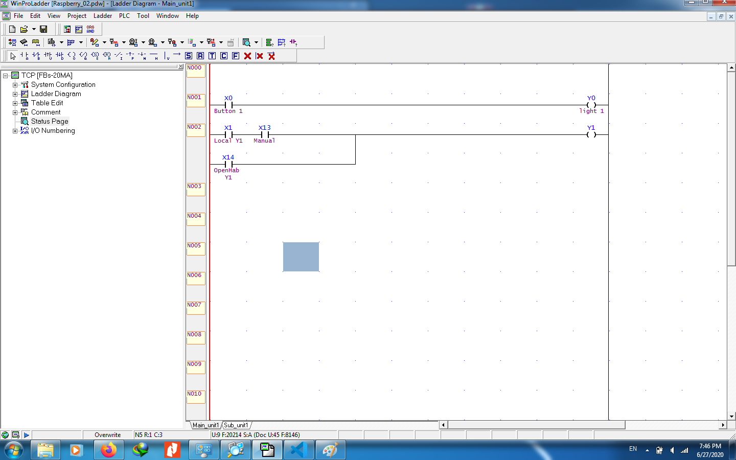

I can not change fatek plc discrete input while it is running… it changes just when plc is in stop mode… can you help me… best regards
You can’t because you use an X or M marker that you want to control, more than once in a ladder.

i wanna change X0 or X1 online … but i can’t… can u help me please
what should i do?
This should work, show me your .items please. And what you see in the log.
This did not work.. i define M0 and use it .. M0 or M1 or M2 .. they change while plc is running

Trust me that X also work with OH, but it is good practice to map X and Y to M. One more thing, your ladder will not work with physical switches. In OH, you use (bistable) switches, while your wall switches are actually (monostable) contacts.
