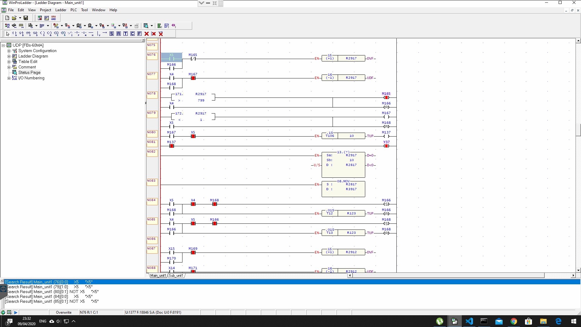

I attached picture from my lader, X5 turn the light on, X4 turn the light off.
Ty for your help!
Hi.
It’s only part of the lader. How the dimmer is connected to PLC only with Y37? when X5 increase the light and X4 decrease. Please read this.
I am really search on forums but find nothing. There are not many posts with Fatek plc.
This is just example from the lader, If I understand how to do that with 1 light i will do it for all.
I succced to turn the light on and off with simple rule but dont succes to make slider that increase/decrease and light.
I am giving you this link not to search this forum, but to learn how to ask a good question. It’s like Rossko57 says “It’s like pulling teeth”. Now I can’t help you because I don’t know anything about your configuration. So I need to know:
What dimmers do you have or how do they work, or how X4 and X5 works now.
How dimmers are connected to the PLC or a pice of the Lader code responsible for controlling the dimmer.

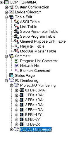

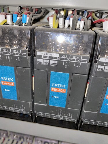

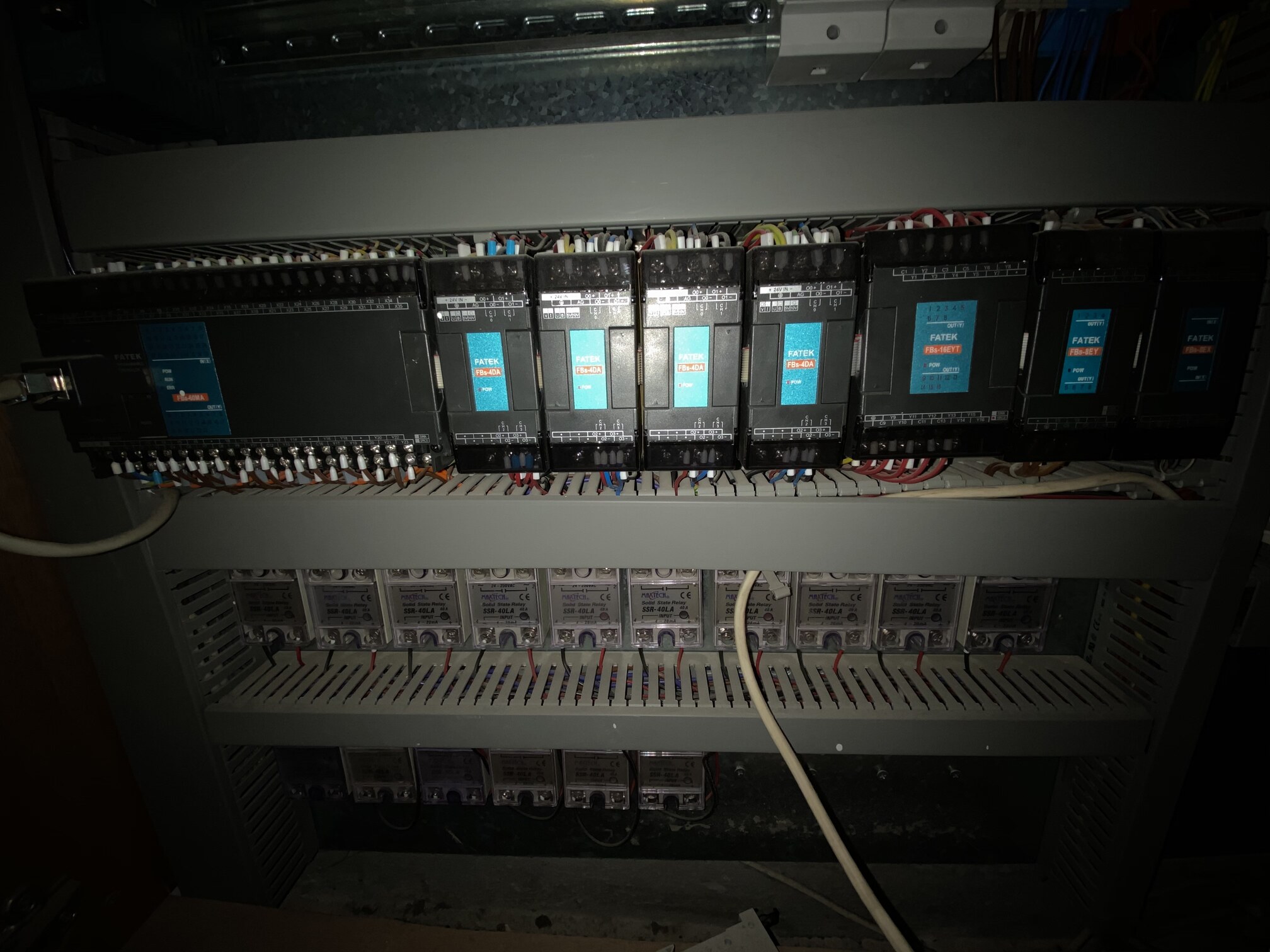

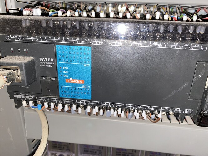

Ok, sorry I try to be more specific,
The model of the plc is FBs-60MA, In this plc I have 13 light dimming.
The model of the dimmer is FBs-4DA.
As I said the guy who built all of my electric panel are not available more and I cant ask him what he did.
The things that I know is that dimming value is 1 to 800, 1= off and 800= full power.
The picture that I sent is my bedroom, X5,M166 increase the light and X4,M168 decrease the light.
I attched more picture. Please tell me if you need more infromation amd sorry again It’s just because of my lack of knowledge.

I’m runing out of time, will look later at this. Meanwhile you can add R3817 as a dimmer item to OH with range 0-800 and try :slight_smile: if it not help, i will need a Lader with dimmer code.

But the light is flashing because the value from OH has been overwritten by the PLC Lader.

But this will not help, as I wrote earlier, Lader needs to be fixed.

What I need to fix in my lader and how can I do it?
Lader

You must convert the value 1-800 to the percentage of 1-100%, then control register with 1-100% from OH.
All you can find here You can addopt N243 to N262 its shades control. There is also a dimmer program there, but it works a bit differently because it’s Modbus dimmer.
