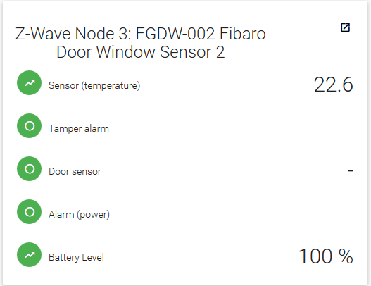

After having some trouble with my openhab2 setup, i did a total reinstall and now i can see my FGDW-002 door/window sensor in OH2.
But, i only get the temperature, and not the door status. Has anyone else got one that is working?

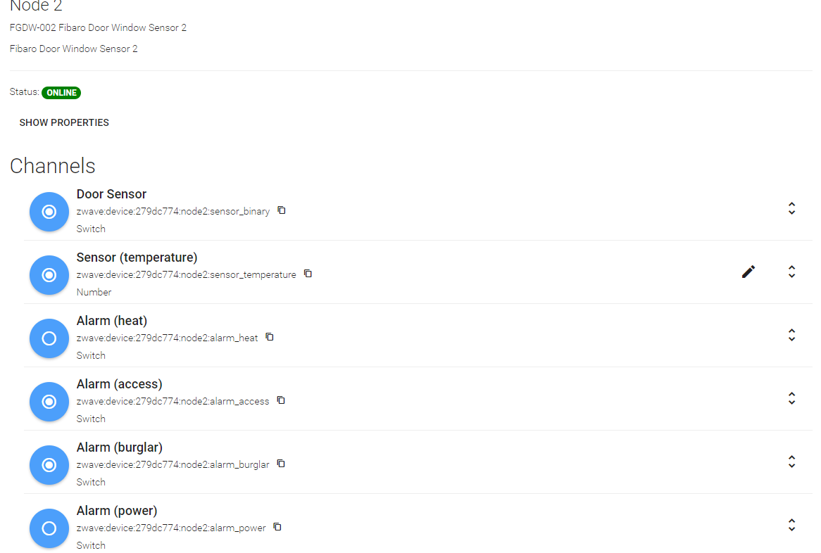

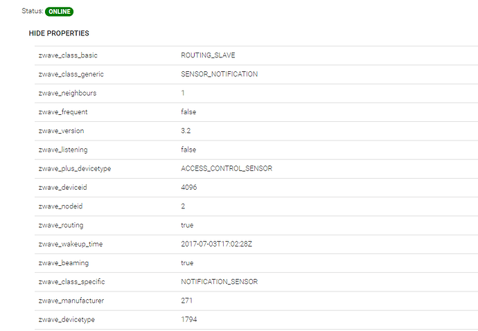

I also have this problem. I recently got my FGDM-002 recognised with the help of Chris (see this topic).
Now the device is recognized and properly initialized, It does not report the sensor_binary field but the alarm_burglar and alarm_access items are triggered. Iāll see if I can add some zwave debugging log.

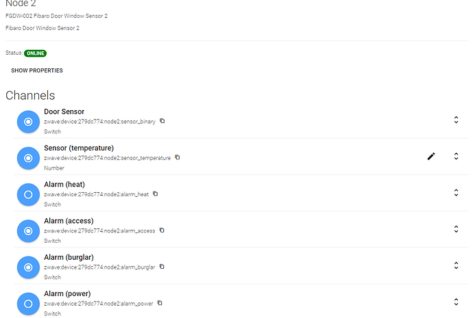

To rule out itās the secure communication thatās not working, Iāve changed my configuration to this (changed #3 to ānone of the groups sent as secureā):
I also tried configuring the FGDW with PaperUI, but it doesnāt allow to set a value of ā255ā for the āassociation for openingā parameter:
Iāll report back if it helped.
I think this was discussed elsewhere a few days ago. At the moment the way the database is configured is to use the binary sensor command class. The device probably defaults to using the notification command class and thereās a setting to change this in the device.

Chris had the channels updated in the development binding. I can confirm that the door status now works if using the very latest development build of the binding.

Are you sure that the sensor should work with the standard 2.2 version? I tried to add the sensor and only some information are working for me (except sensor open/close). Do you have any ideas how to get it work? Thanks for your help!

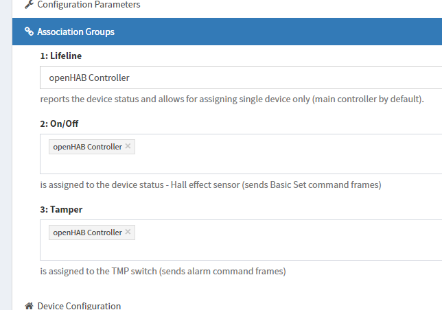

I added the openHab Controller in the Association Groups 2 & 3. Iām not sure if this made it working or the update to the newest binding version.
@masterchris_99 Thanks a lot for the hint. I added the openHAB Controller and now it is working.

I had the same issue, the sensor was not itenditfied.
After adding the OpenHab Controller to the Association Groups, I get the temparature and the battery level.
Unfortunately, the door sensor itself is not working.

i just added 3 window door sensors yesterday and after adding the OpenHab Controller all of them work just fine. The only thing is that the door state wont show anything till the action needs to be reported aka open/close the door.
