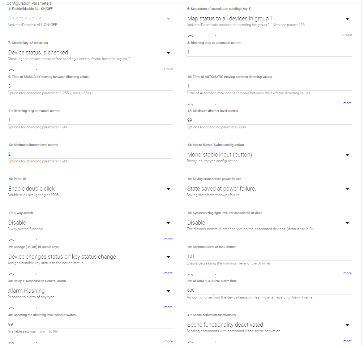

I have a mix of Fibaro FGD211 & FGD212 dimmers using Mono-stable input, since the upgrade, the FGD212’s work fine, but the FGD211’s I’m no longer able to control from the button, i get no response. If i press & hold for a few seconds then turning it off or on works for a few seconds before stopping again.
The config looks fine, so I’m not sure what’s happening. Any Ideas?
I’ve no idea what can cause this. All I can suggest is to check the configuration as that’s about the only thing that can change the device functionality.

Think I’ve fixed it, the “Controller Updates” field was blank, I set it to “Controller” & saved, then after a few minutes they started to behave normally again.
