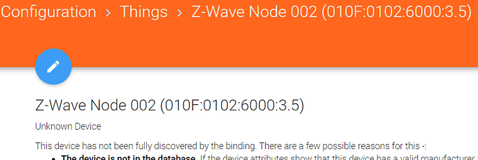

Habmin screenshot:
Habmin Screenshot

As far as you can determine, is your device the same as the one you linked to? If so, we can add the ID.
What version of OH are you running? On some versions you can manually update the binding when a new version is needed. The database is part of the binding.
