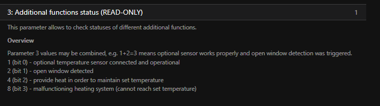

  1. Are you sure the optional temperature monitor (FGBRS-001) has been paired? I believe that device is the intended source for EP2, (both battery and sensor). Also does parameter 3 show the remote device?

From parameter 3 picture, the optional sensor is connected and operational
