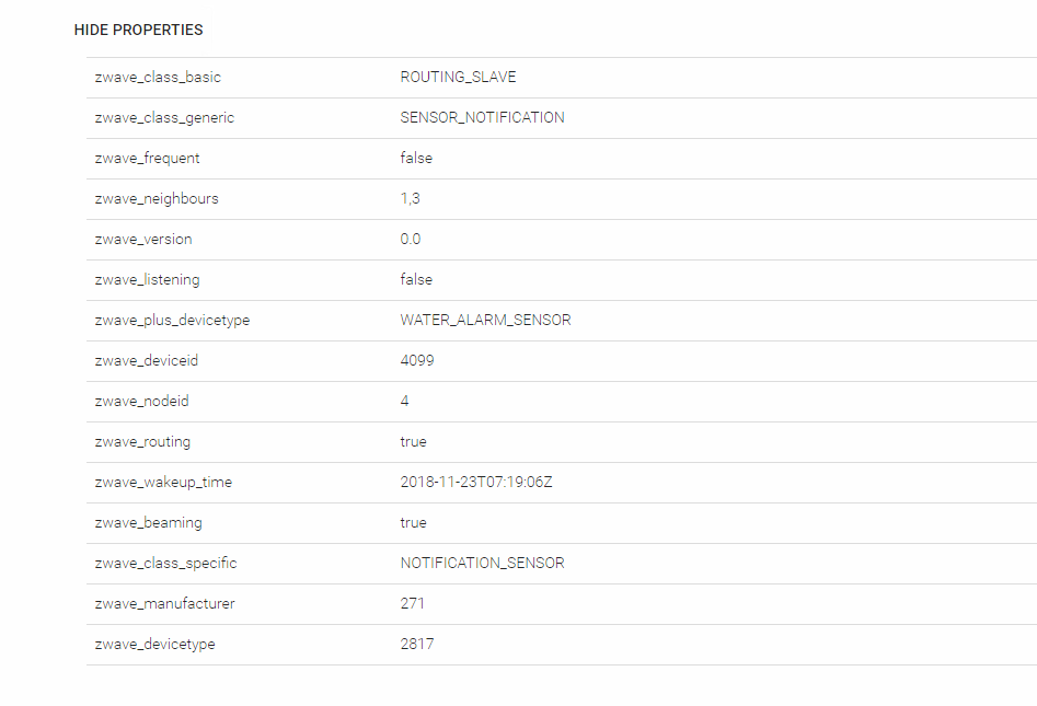

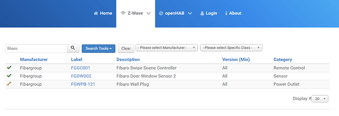

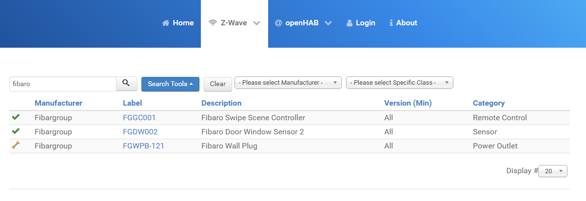

but to a complete noob there is not much I understand there. But if I look up Fibaro devices the database seems to miss the Flood Sensor:
In the link above about the database it also says that I should write in the forum about this so someone more experienced can possibly help with this.
To me it seems like it is simply missing in the database but maybe there is something else going on.

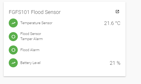

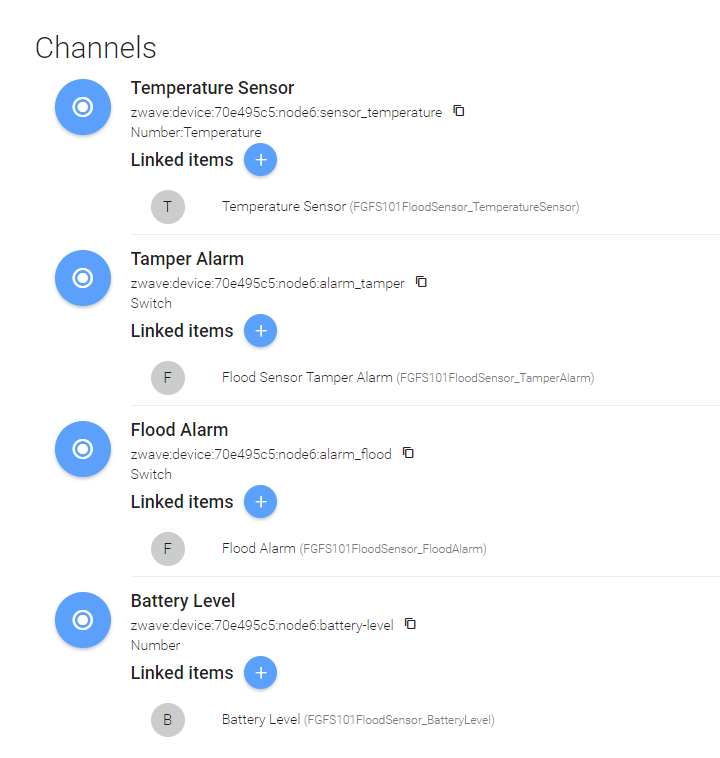

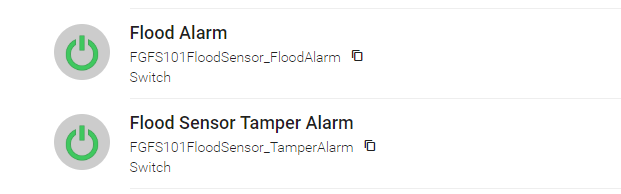

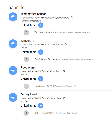

It is now added nicely to openHAB as a thing, all looks fine and the thing is also linked to items.
Items:
If I do a manual wake up, it also looks fine in the log:
Flood Sensor Error Log.txt (620 Bytes)

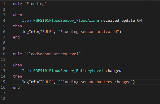

But when I manually trigger the flooding (two wet fingers on the contacts), I can’t get the item rules to react. The Flood Alarm is reacting in itself as expected (beeping and led blinking).
I have done some different rules just to get it going but nothing happens. Nothing in the log and no reaction in the rules:

But no matter what I do I cannot get the most important event to fire in a rule, the flooding. This leads me to believe that I am doing something wrong with that event - should it be formatted in a different way? I wrote this just to catch everything:
Item FGFS101FloodSensor_FloodAlarm changed
logInfo(ā€œRULEā€, ā€œFlooding sensor activatedā€)

The configuration looks ok.

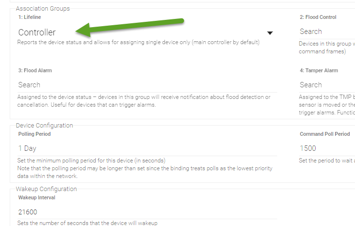

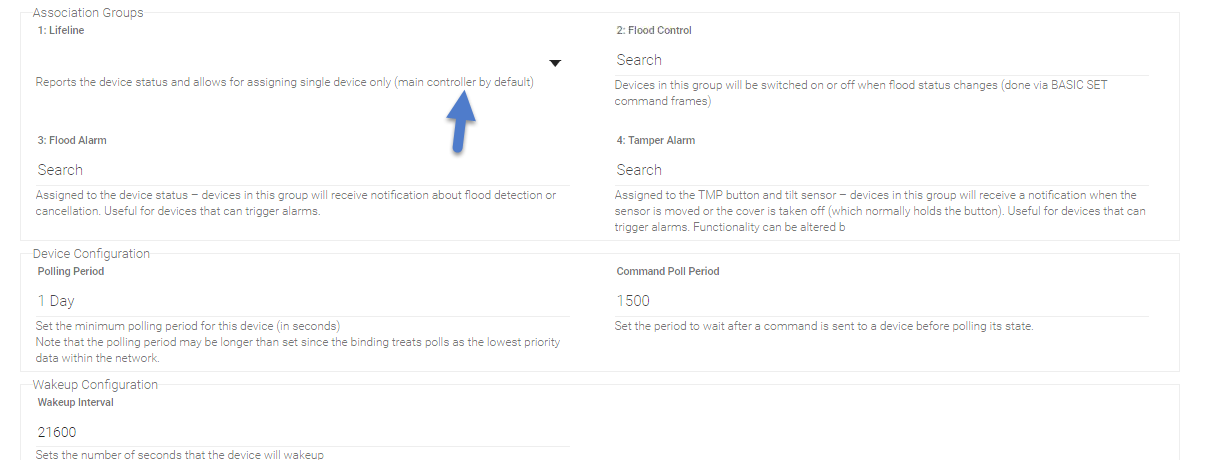

Are you certain association group 1 (LIfeline) is set to the controller?
I did set it from the beginning but then I reinstalled the system and did not actively set it again. It says it is on the controller by default, however I cannot confirm that. I have now actively set it to Controller and will test again this evening.
This is how it looked before I actively set it:
This is how it looks now:
SOLUTION
So, there is obviously no ā€œmain controller by defaultā€ for association group 1 (LIfeline), you have to manually set it to the controller. And then it works!
