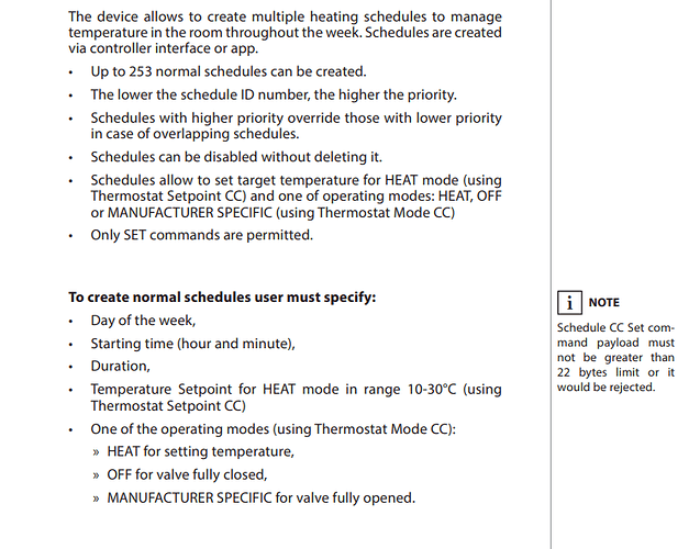

It seems you are right. I read about multiply schedules possibilities and this is not possible within exisitng openhab functionality.
Wondering if change on this is planned in the future releases of openhab.
