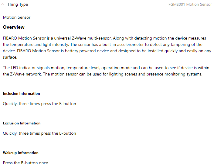

The binding does not allow enough time for full configuration after initial inclusion, so rewaking is necessary. If this is anything like my fibaro motion device, the wake is only one push, about a second. Three pushes send a NIF that is great for inclusion, but not waking. Try the one push a time or two.

The 1 second is just an estimate. Could try .5 sec. Also the sleep timer is 5 seconds, so if it does wake, probably only have to wait 10 seconds between attempts.

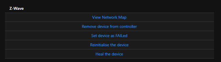

The new one does have a 5th option to reinitialise the device :
