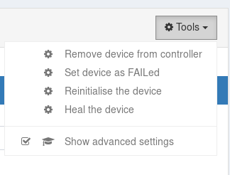

In HABmin: select device–> Tools–> Show advanced settings
Steps:
  1. Set device as failed (if it is really failed)
  2. Remove device from controller
Do I really have to set it.to failed before removing it?
No. Only if it’s failed.
Normally you should just exclude it. Go to controller in HABmin. Tools → Show advanced settings
→ exclude devices → triple press button on Fibaro Motion sensor.

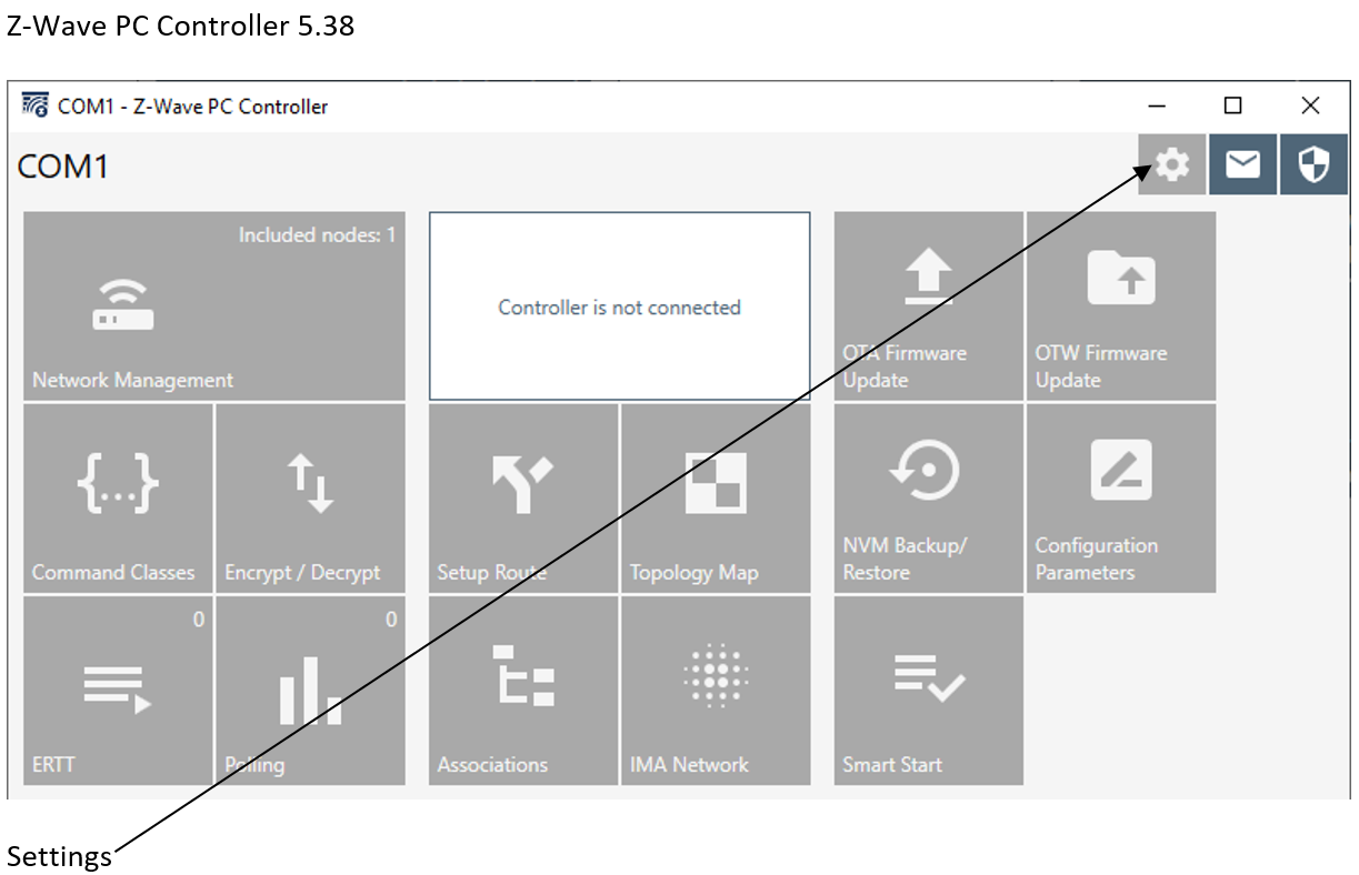

@chris400
Then you need an other solution.

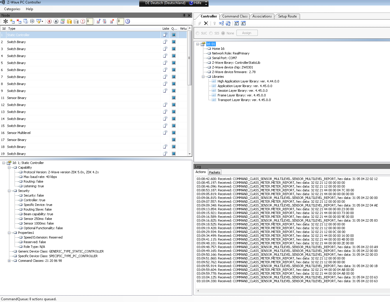

You need a Windows PC.
Install this software on it:
Z-Wave PC Controller 5.38
Or this software:
Zensis Tool 4.7
Stop Openhab. Unplug controller stick, if your openHAB is on a Linux machine.
Plug your controller stick into Windows PC.
Install the driver for your controller stick for using a virtual COM port. (e.g. COM3)

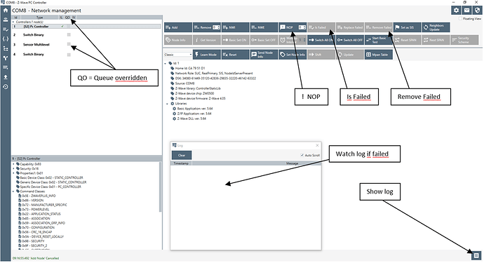

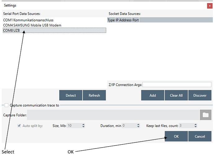

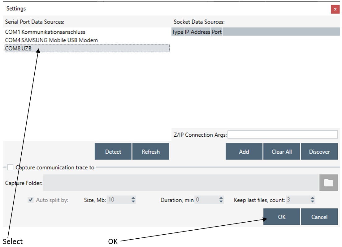

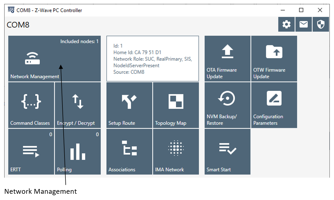

Open “Z-Wave PC Controller 5.38” or “Zensis Tool 4.7” and follow these steps:
  • select correct COM port.

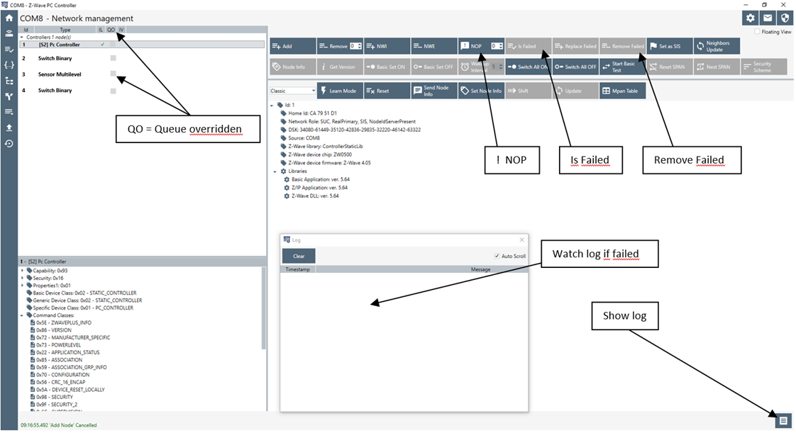

  • highlight your dead node
  • Send NOP
  • Send IsFailed
  • Send RemoveFailed
Details you can find also here.
Here a picture of the tools frames (Zensis 4.7):
Zensys_Tools
Please note for the future that you first exclude the node from the controller before you reset the device (=node).
@chris400
Using “Z-Wave PC Controller 5.38” (I’ve never used it for this case!)
I hope I have labeled everything correctly, you are welcome to correct me!
ALL STEPS YOU CAN FIND HERE. There are also other links to all kind of removing topics…
