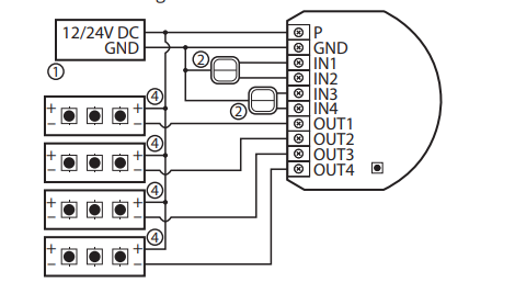

I have recently both RGBW Controller 2 from Fibaro and connected my two LED strips according to the pictures in manual. OUT1 (R) OUT2 (G).

I defined Dimmer as switch to ON/OFF both strips. Dimmer 1 and Dimmer 2 shall control the White LED strips with pwm width 0-100% connected to OUT1 and OUT2
Dimmer works fine. But i think Dimmer 1 and Dimmer 2 are connected to each other. I can change the brightness with both channels (?) If I set one of the parameters (eg. 50) on a slider. After while it changes the value to lower one. This is very confusing me. Does it have sth to do with parameter

How to configure RGBW Controller to smoothly dim OUT1 (R) OUT2 (G) with the slider?
Reading this post I doubt there is a possibility for a simple dimming control of two white LED stripes independently.
I just want to slide the brightness from 0%-100% on two outputs.
Was someone able to manage it?
